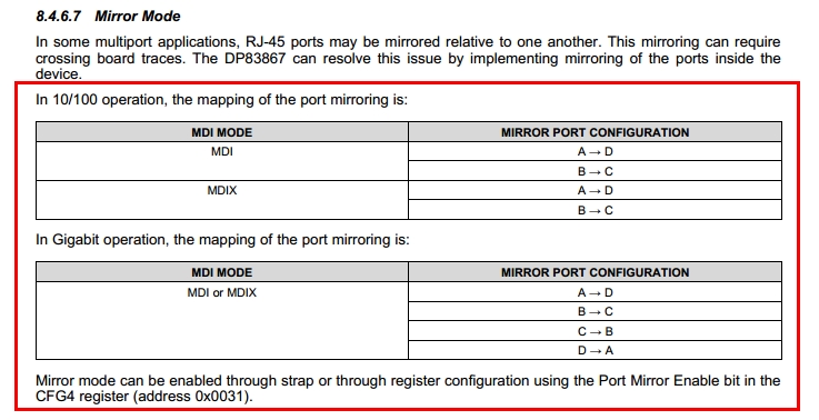

I am asking a question about the DP83867IR mirror mode description in page 18.
Coul you please check see below table, which I think it is not correct, please help double check.
Such as in 10/100M mode, C and D should not be used, right?
I think the correct description should be show as below. please correct me? thanks.
10/100M:
A->B
B->A
XX
XX
1000M:
B->A
A->B
D->C
C->D
