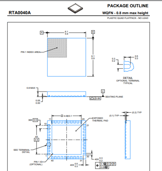

Hi There is no dimension in the datasheet. Could you advice the height?
http://www.ti.com/lit/ds/symlink/ds90uh928q-q1.pdf
