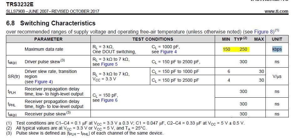

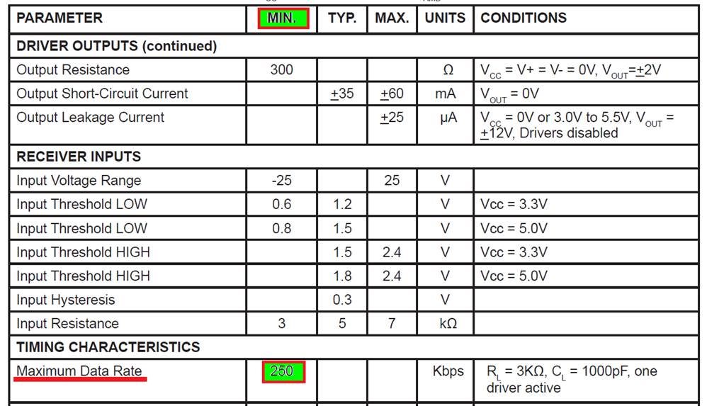

I am trying to replace Exar SP3232EB with our TRS3232EI and my customer has one concern on the datarate.
In SP3232EB datasheet, the minimum value of the maximum datarate is 250 kbps.
However, the datarate is shown as 150 kbps(min.) and 250 kbps(typ.) which says that our datarate could be in the range of 150 kbps to 250 kbps.
My customer is concerned about this since they need the datarate to be higher than 250 kbps.
Is it just related to the way of defining the spec or our device just behaves this way?
