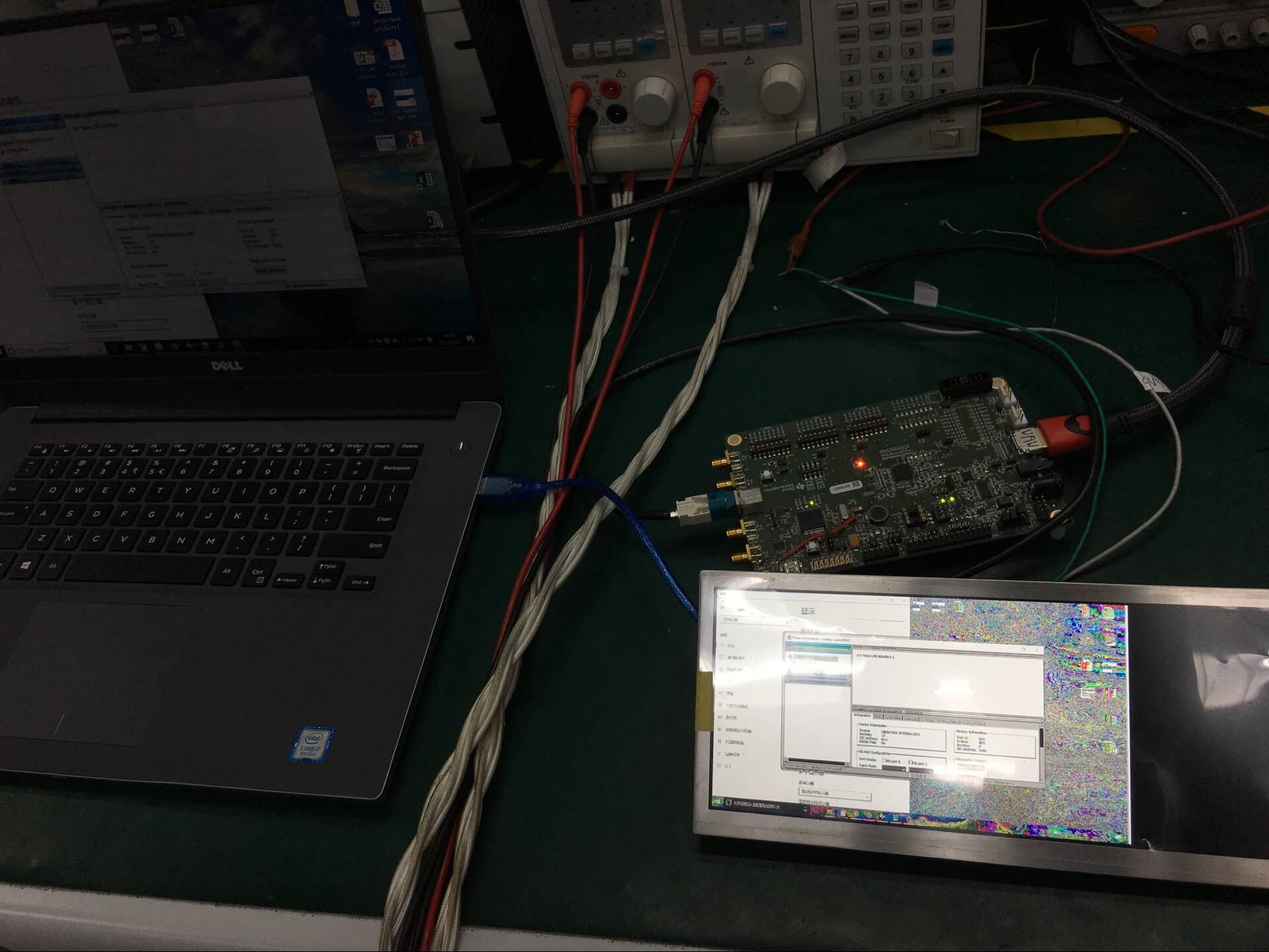

Computer HDMI output to DS90UH949EVM to DS90UB948 to Screen,Display anormaly. 0x22 no set 24bit Video picture

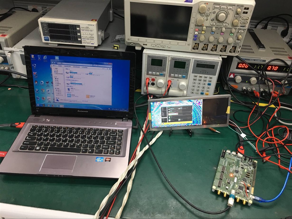

If, I set ub948 0x22(2) to 18bit Video,Display normaly (but the screen is dark),As attachment 0x22 set 18bit video picture.The color is wrong.
How could I configure?
