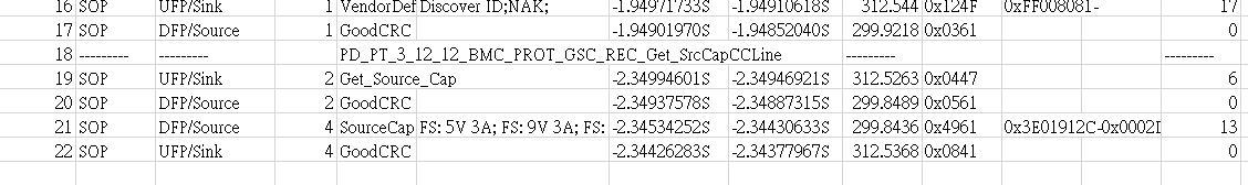

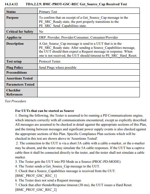

 My customer is asked to test TDA 2.2.9 (BMC-PROT-GSC-REC) in their TPS65983A dock product in GRL. Our device can't pass that test because we don't response Hard reset after 30ms in reporting  SourceCap. They use TPS65983 FW 4.45 now. Please help to check the issue. Thanks.
It's the test log from GRL.
This's the failed description.

  • Hi Gary,
    This is a FW bug in the 83 FW. This issue will be resolved with the next FW release. Currently, the FW version with the fix was sent to Intel and they are validating it. Once they have confirmed it, we will release it through the secure site.
