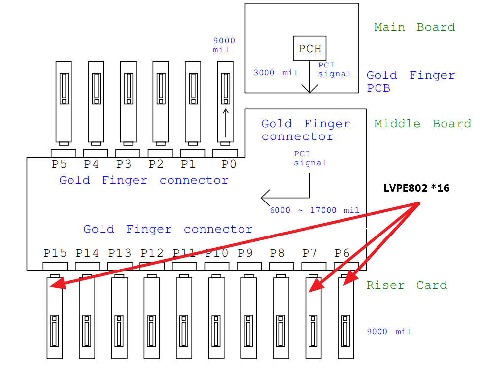

Hello Sirs,
Its urgent need your suggestions !
1.Need your help will SN75LVPE802 OK for PCIe GEN1 x1 (2.5Gbps)?
2.Per PCIe FR4 trace loss 0.25~0.35 dB/inch .
Would you provide me what's LVPE802 EQ gain for "1" . "0" and "NC" ?
Datasheet only provide PCIe GEN3 EQ .
3. Refer to another LVPE802 E2E . I see these words .
Is it not recommend only for PCIe GEN3 ? Or its including PCIe GEN1~3 ?
"I do not recommend the SN75LVPE802 for PCIe applications. Instead I recommend the DS80PCI102 or the DS125BR111."
