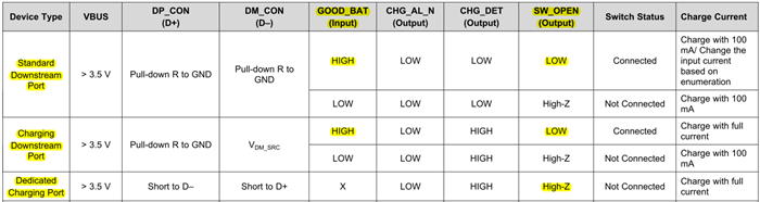

The CHA_AL_N is required to have a 10K pull up. The CHG_DET should have a 10K pull down. In what application are you using the BQ24392 without DP_HOST and DM_HOST connected?

Customer wants bq24392 to detect only DCP or SDP/CDP
Customer use bq24392 with 5 pins and 1 pin pulled up.
DCP is high, and SDP / CDP high and low are distinguished.
The customer made a detection by this.
・Pin4 CHG_AL_N is open drain.
・CHG_DET is push-pull.
Please tell me the disadvantage of setting these two terminals to OPEN.
Could you give me your advice?
Yusuke/Japan Disty
