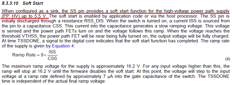

Hi Team,
It seems SS pin is used only when configured as a sink.
Can we leave SS pin open if our application is source only?
