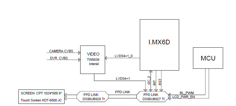

Part Number: DS90UB928Q-Q1
encoded DS90UB927QSQE,Decode DS90UB928Q-Q1;The whole machine starts normally and enters the radio interface,And then two seconds into the reverse, after Back-up camera video,So repeat it for about 2 hours. the Whole unit black screen. beyond retrieve.Sometimes the read register goes wrong and sometimes the video stream is normal.
