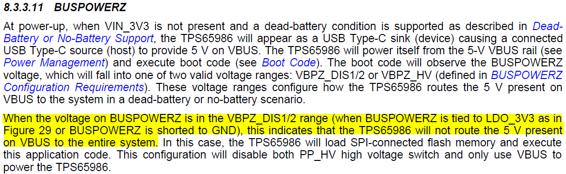

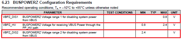

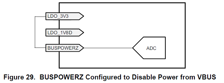

Hi Team,
I believe it becomes absolutely same function between VBPZ_DIS1(BUSPOWERZ < 0.8V) and VBPZ_DIS2(BUSPOWERZ > 2.4V).
Is my understanding correct?
Yaita / Japan disty
  • Hello Yaita,
    Yes, the VBPZ_DIS1 and VBPZ_DIS2 effectively serve the same function, defining the voltage range for BUSPOWERZ, and when to handle a dead battery condition.
