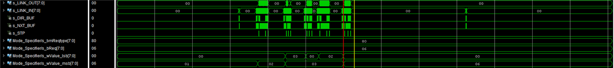

also i attached debug result that shows data transaction contain  SETUP, IN and OUT packet are correct:
please let me know what is the problem.
