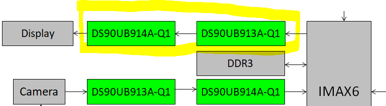

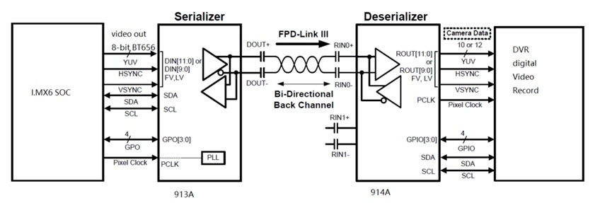

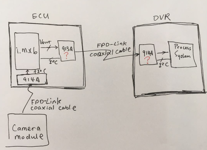

Can DS90UB913A-Q1 and DS90UB914A-Q1 be used in the following applications:
Input is not from camera. It is as below.
SOC ----(video out) ----- > 913A -------(STP/COAXIAL CALBE) ----- > 914A--------- > DVR (digital video recorder)
