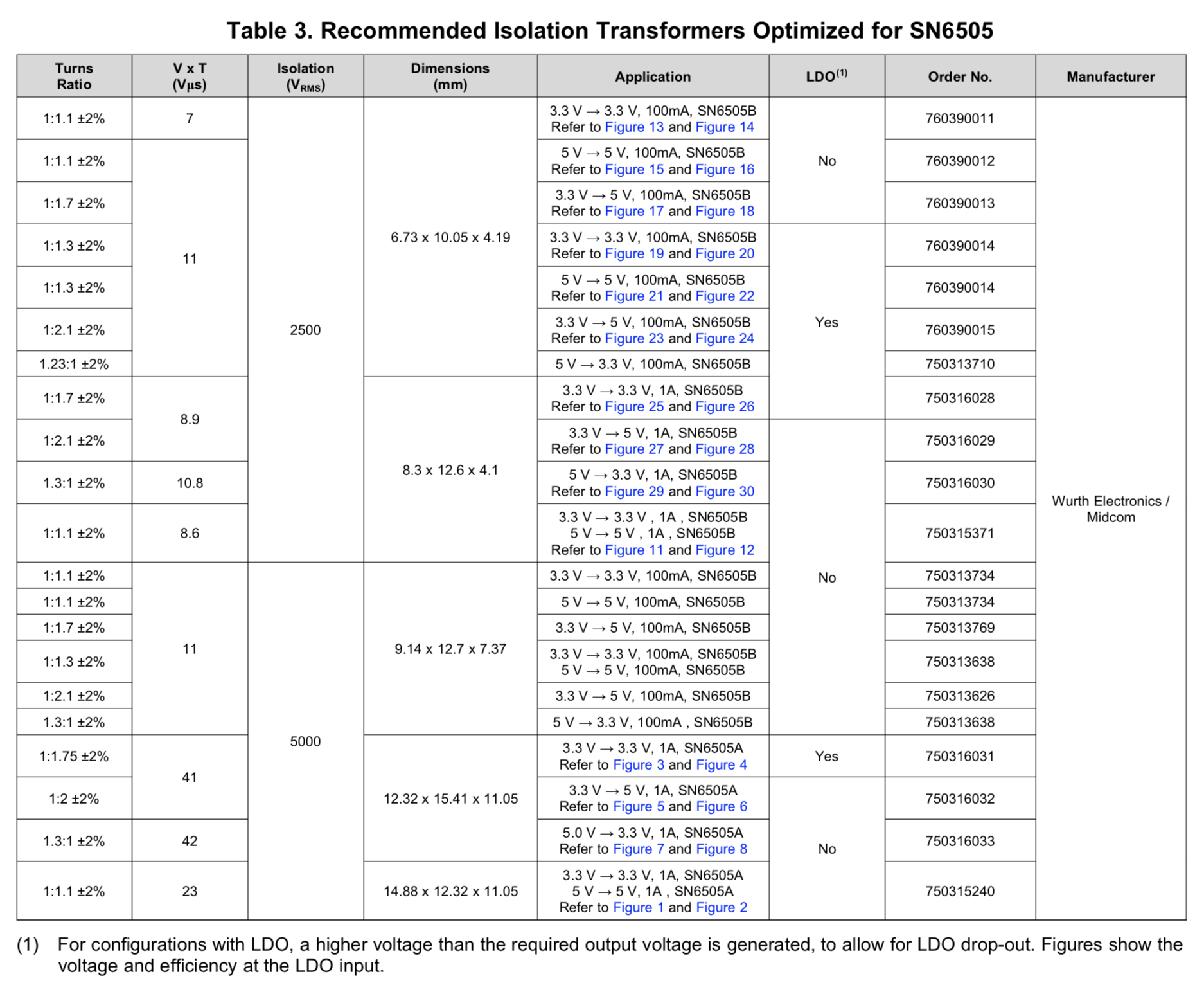

 One of our customers is considering useing SN6505A. They'd like to use the device with 3.3V VIN and  5V transformer center tap. Could you please tell me whether this usage is no problem or not?

    Thank you for using E2E Forum. The answer to your question is yes, a center-tapped transformer can be used with SN6505A to generate 5V from 3.3V supply. Example transformer options are shown for various voltage/current configurations in Table 3 of SN6505 datasheet (also copied below). You can use any of the transformers listed in the datasheet or if you have a different preferred transformer vendor then you can choose transformers from your vendor with the specifications given in Table 3 of SN6505 datasheet.

    Could I ask you a question again to make sure my understanding is correct or not because VCC of SN6505A is connected to the center tap of transformer in the device datasheet?
    The customer wants to supply 3.3V to VCC of SN6505. But they wants to supply 5V to transformer center tap without connection between VCC terminal and the center tap of transformer. The usage is no problem?

    Thanks for reiterating & clarifying your question and I am sorry that I miss understood your question earlier. Yes using 3.3V for VCC of SN6505 and 5V for the center-tap of transformer on the primary side is absolutely fine. As long as the voltage at D1 & D2 doesn't exceed the abs max value of 16V, you can use this configuration and there shouldn't be any issues in doing so. Thanks.
