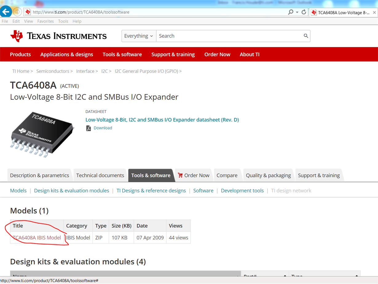

Could you please provide the IBIS model for TCA6408ARSVR?
  • Hello Anitha,
    I think you missed the link in the TCA6408A product page.  If you look under the "Tool & software" tab the Ibis model is there.  Let me know if there is something wrong with it.
    -Francis Houde
