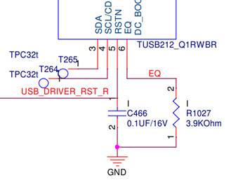

Hi Sirs,
Sorry to bother you.
Our question is when we load mp3 from USB Flash Drive, there will delay 10s then start to play music.
The default is mid DC Boost. The long cable will happened but short cable didn't.
But if set to high DC Boost, both cable will happen lag phenomenon.
When we set to low DC Boost, both cable are passed.
Actually we have test eye pattern on mid DC Boost setting, it's passed.
So we would like to know why mid DC Boost will meet lag phenomenon even the eye pattern passed?
Thanks!!
