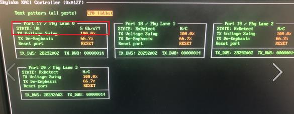

   In my application the TUSB8041 is used to expand 4 port usb from X86 system. The upstream is connected to PCH of X86 system and 4 downstream port is as USB connector. But in USB compliance test of out SI lab, the RX signal couldn't be test because it couldn't get in loopback mode. The below information is get when RX compliant test running. Please help us to solve this issue and let the compliant test of Rx keep to go. Thanks.
Note:  The TUS8041 EVM has been run USB compliant test in our lab. But it still couldn't get in loopback mode in Rx test.

    Can you confirm that the host controller driver is not resetting the TUSB8041 ports went they attempt to enter loopback? We have found many host controllers will reset the downstream ports of the hub when they report a port status of loopback. Otherwise, can we get a photo of the test setup. we don't have issues in our lab.

    To keep the hub downstream ports in loopback mode, they need to confirm that the XHCI controller is not resetting the ports or the hub.  For typical lab testing, we install the XHSETT tool from usb.org on the host controller to prevent any unexpected XHCI driver interactions.
    We’ve had 100s of customer run compliance on this device without any issues.  If they can confirm that the driver is not resetting the ports, they can try adjusting (increasing) the LFPS amplitude to see if that impacts the RX lock.
