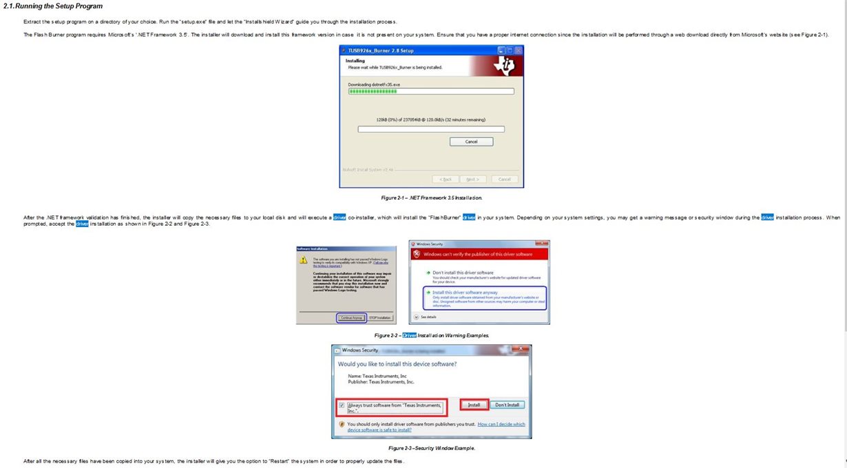

  • Hi All,
     I am referring section 2.1 from sllu125d.pdf document. Attached is the image for installing flash burner software. When the software is installed, the driver also getting installed automatically as per the procedure documented in the sllu125d.pdf document.
    But in windows 10 - 64 bit PC, when i installed the flash burner software, i am sure that the driver is not getting installed. because the installed does not ask for any confirmation to install any diver installation as part of driver installation process.
    So i am doubting that the installer may work well in lower version of windows operating system but not in windows 10 - 64 bit Operating system. So if anyone would help me to get driver for windows10 - 64 bit operating system that would be highly appreciated.

    Thanks for your reply. Already i have the firmware file with me. What i am asking is, when the flash burner software is getting installed, it will install the driver for the TUSB9260 Boot Loader as well ( Refer Figure 2.2 and 2.3 in sllu125d.pdf document).
    When i install the flash burner application software in windows 10 - 64 bit OS, installer did not ask for the steps to install the driver as mentioned in Figure 2.2 and 2.3 in sllu125d.pdf document. So the flash burner software is not allowing to flash the TUSB9261 SPI flash.
    I have both flash burner application software and TUSB926x_Firmware_v1.05.zip. What i am requesting is the driver for the flash burner application software

    I tried the same. But in the default folder "C:\Program Files (x86)\Texas Instruments Inc\TUSB926x_Burner", the driver is not available.
    while installing the TUSB926x_Burner_2.10.0.exe that creates and installs the files in the "C:\Program Files (x86)\Texas Instruments Inc\TUSB926x_Burner" folder.
    Also the installation process should install the driver. But that is not happening in my case. Below sequence is not happening in windows10- 64bit.
    Kindly suggest how to get this driver installation step which will install driver in "C:\Program Files (x86)\Texas Instruments Inc\TUSB926x_Burner" folder..
