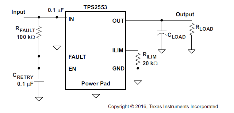

Can TPS2553-1 be used in below circuit for auto retry function?
In my opinion, I don't think it can work like TPS2553 since in latch mode, the fault will be always low during fault condition, so the EN can not be charged to high.
Am I right? Thank you.
