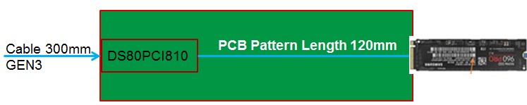

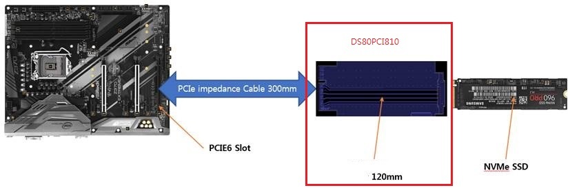

DEARS.
DS80PCI810 product is under consideration.
We are reviewing the configuration below.
We need to extend the PCIe signal by about 400mm.
The data sheet of the DS80PCI102 has an Equalizer related setting method(Datasheet 13page, Table 2. Equalizer Settings)
I want to know how to set the Equalizer for the length in DS80PCI810.
What are the best settings?
