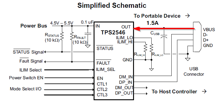

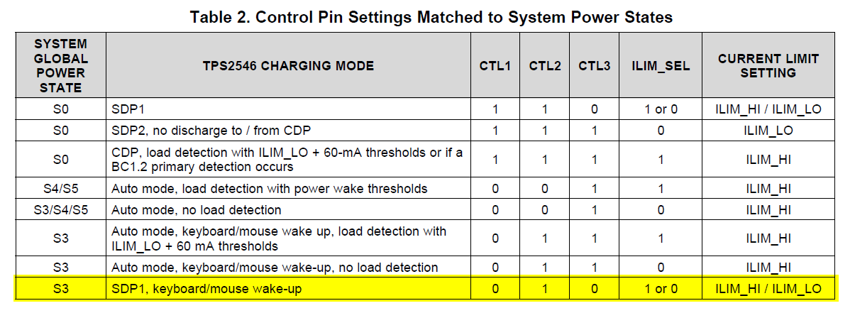

Hello, hoping to get some pointers or advice on using this evaluation board. I have been trying to switch between SDP2 and CDP mode (1110 to 1111) and am getting some weird results. I have replaced the 80k resistor with a 210k resistor to achieve a current limit of ~240mA. Here is a quick summary of what happens during my tests:
SETUP: USB data line capable of 1.5A into EVM, EVM to Android tablet
1. Start up in 1111 mode, measured about 1.3A going to the tablet. Everything is good, data communication works.
2. Plug in jumper for ILIM_SEL to switch to 1110 mode, measure about 250mA, data still working.
3. Unplug jumper for ILIM_SEL to switch back to 1111 mode, The current reads roughly 550mA, data still working. It doesn't get back to 1.3A charging current unless I reset the chip with the EN pin.
Is the chip capable of switching back to the higher current fully or am I missing something?
I also tried to switch to a much bigger resister for ILIM_LO (604k). On startup, it seems to work, measuring about 100mA with working data communication. However removing and reconnecting the ILIM_SEL jumper doesn't seem to do anything, the charging current stays at 100mA. Is the current limit too low for the chip to switch? It does say the resistor limits are 16.9k to 750k in the datasheet.
