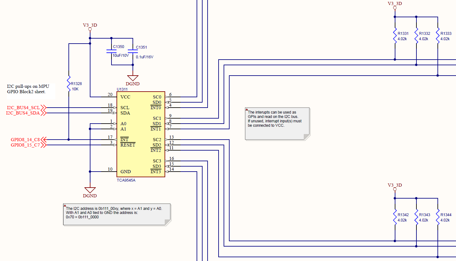

When setting or asking for the active I2C channel the switch responds as expected. However, there is no activity whatsoever on the "channel side" when trying to communicate with devices connected to any of the channels. All channels are stuck at logic high. It's like the pass-gate transistors never turn on and let anything through.
The 2.6 V on the right side should be ok according to the datasheet figure 17 and page 18. I'm not sure about the unused interrupts and unused channels though. Could the pull-up to 3.3 V cause any problems?

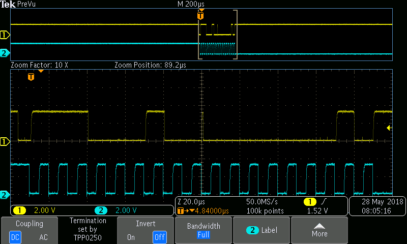

  • Here are some oscilloscope images from the master side (pin 18 and 19). The address of the switch is 0x71 (not 0x70 as shown in the schematic).
    The master sends 111 0001 0 (address = 0x71 and it's a write) and the switch responds with an ACK. Then it seems like the slave releases the line before the master starts to send the control register, which causes a short glitch, but that shouldn't matter. The control bits are 0000 0001 which should activate channel 0 on the switch. After that the clock is held low. Don't know exactly what is going on here, but it seems like the switch stretches the clock by some reason.

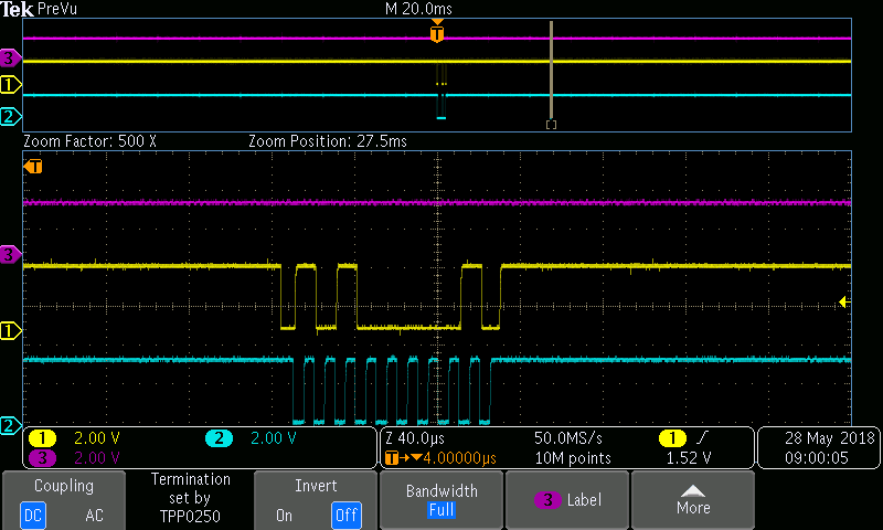

    Next image, the master reads back the control register.
    The master sends 111 0001 1 (address = 0x71 and it's a read) and the switch responds with an ACK. The switch sends back 0000 0001 to the master, which corresponds to the what the master wrote in the first step. The master replies with a NACK indicating it's done reading the bus. Again. it seems like the switch makes use of clock stretching.

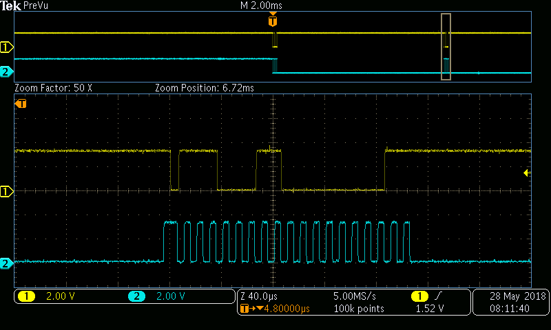

    Last image, the master tries to communicate with a device on channel 0. Address is 101 0000 (0x50). We got a NACK since the channel side is dead and nothing answers. The purple probe is the SCL line on the channel side.

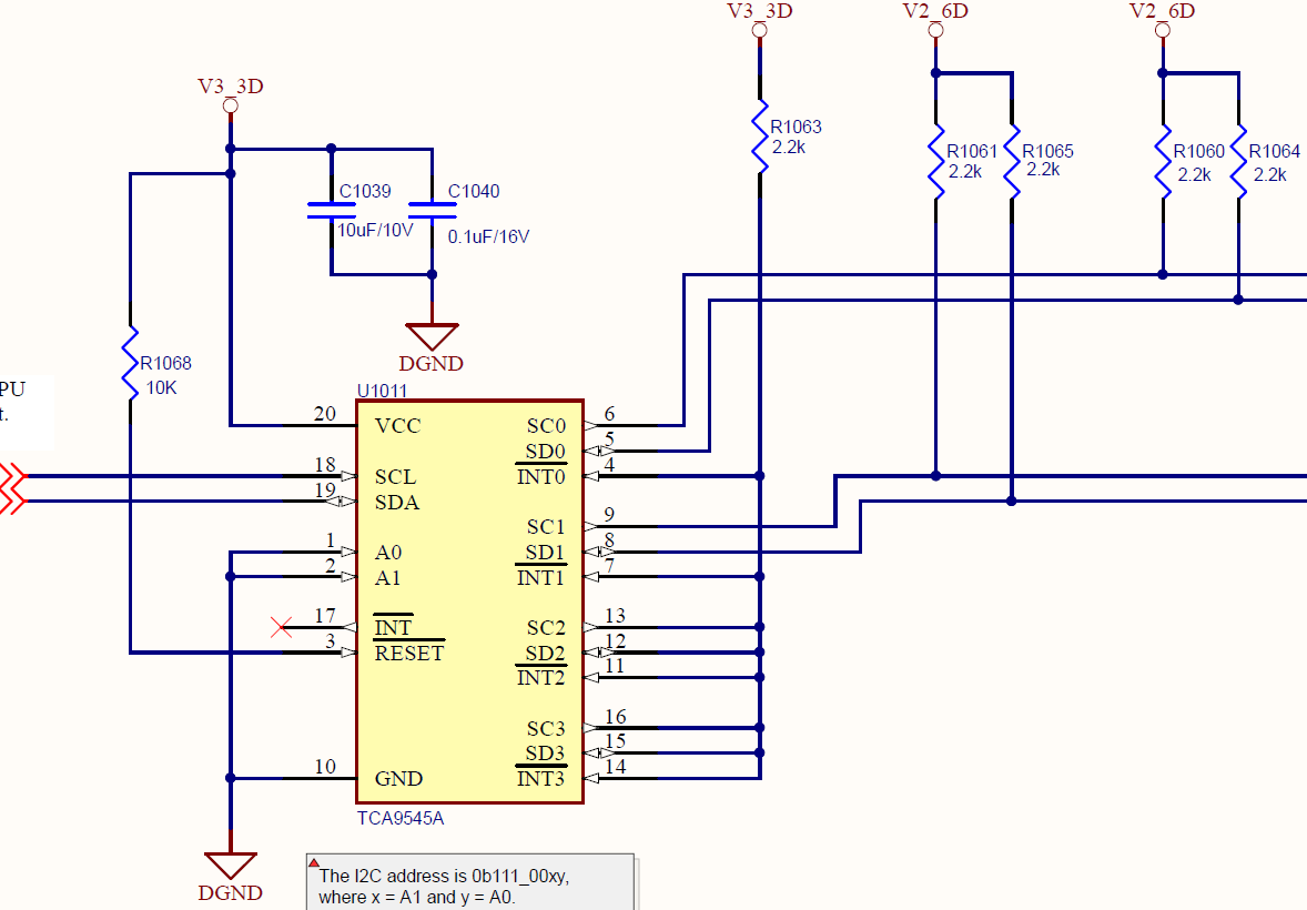

  • More information. The other instance of the switch, which showed to be non-functional as well:
    The downstream devices on this switch are four LM96063 fan controllers and the design is to a large degree based on LM63LM64LM96x63EVM. This EVM works without any problems, but it uses the PCA9545A switch instead of the TCA9545A switch. They are supposed to be identical, aren't they? We are actually using the PCA9545A switch on another custom made board where it's also working without any problems. Are there any differences between the two switches that could cause the PCA9545A to work, but not the TCA9545A?
