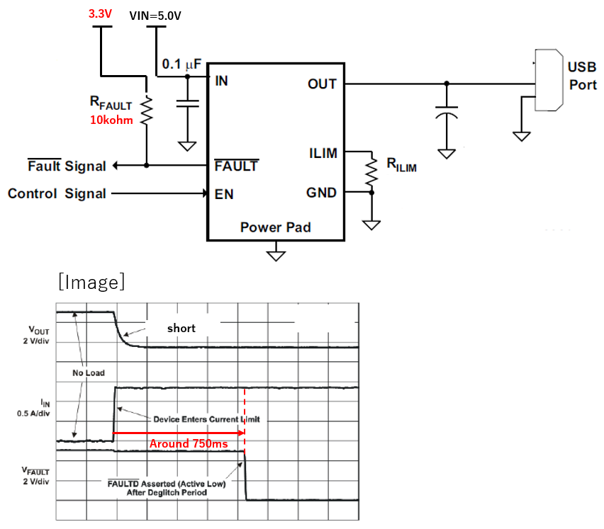

Hi Team,
Our customer is evaluating the behavior of current limit.
Then, an assertion of /FAULT pin is around 750ms so it is slower than 7.5ms in the datasheet.
They use 10kohm for the pull-up resistor of /FAULT pin so it is lower than 100kohm in the datasheet.
Does this value affect an assertion of /FAULT?
If yes, could you please let us know the recommended minimum pull-up resistor value?
Yusuke/Japan Disty

  • Hi, Yusuke-san,
    Sorry for late reply.
    I don't think the pull up resistor will influence it.
    One possible reason is Vin ripple of TPS2553. What's power supply of TPS2553? If it's a DC-DC, can you measure the Vin ripple. If the Vin ripple is big, please try to decrease the ripple and test again.
    If you want to validate whether the reason is ripple, you can use a DC source to supply Vin for TPS2553.
    Feel free to ask if any questions.
    Bob
