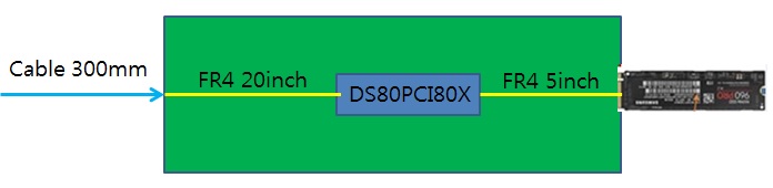

Dears.
Customer compares DS80PCI800 and DS80PCI801.
The customer is considering the following configuration.
Which of the following configurations is better for DS80PCI800 or DS80PCI801?
We need a solution for Repeater configuration.
On the EVM board, it is controlled by a switch.
Can I do all the control with EEPROM?
Is there any problem in operating with all control by software?
Thank you
  • Hi Henry,
    The best repeater for this application depends on how much attenuation is in the total channel. I am assuming there is additional channel on the other side of the 300mm cable. If the total attenuation is > 27-28 dB @ 4 GHz, then I would start with the DS80PCI800. Fortunately the the DS80PCI800 and PCI810 are completely pin-to-pin compatible so you can try both.
    All the control can be done with EEPROM or SMBus commands in software.
    Lee
