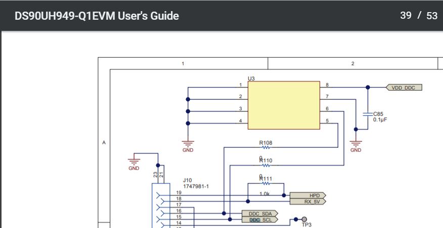

  • Hello Milad,
    A way this could be done is by getting EDID from an external local EEPROM. The DS90UB949-Q1 can be configured to allow a local EEPROM EDID device. See Section 8.3.4.1 of the DS. Also, see table 6. By MODE_SEL[1:0]  input pins, during power up, device can be set to use external local EDID.
    EVM supports populating a EEPROM (U3) for local EDID. Relevant schematic snippet from EVM user guide is shown below:
    An EEPROM similar to this (link below) should be compatible with the 949 EVM.
    Vishy

  • Milad,
    It's not clear if you have used an external EEPROM in U3. Without an external EEPROM loaded with EDID it's not possible to have default 1080p. Device default is 720p so with internal SRAM, you have to load manually.
