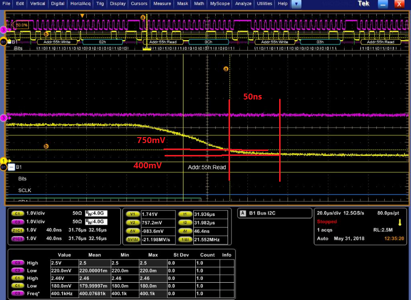

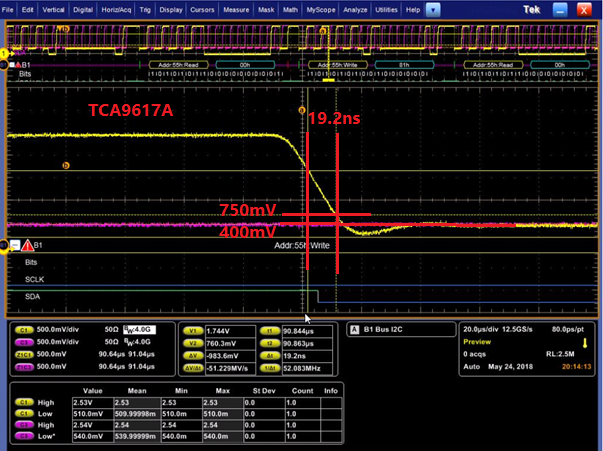

I have a question from customer. Customer changes from TCA9617A to TCA9803, no BOM is changed.
In test , they found the falling edge of TCA9803 is very slow, especially from 750mV to 400mV. 750mV is too high that may be detected as HIGH.
My question:
1. Why is TCA9803 falling edge much slower than TCA9617A, especially from 750mV to 400mV?
2. Do you have some suggestion to fix this problem?

  • Hey Johnny,
    "1. Why is TCA9803 falling edge much slower than TCA9617A, especially from 750mV to 400mV?"
    You've posted a schematic of TCA9617A but are you actually using the series resistors on SDA/SCL on B side (R951 and R952)? Series resistance on an I2C line will slow down fall times of devices.
    The TCA9803 also works differently than most buffers in the sense that it has its own current source on B side so you should not have pull up resistors on this side (R949 and R950).
    "2. Do you have some suggestion to fix this problem?"
    Please remove pull up resistors on B side of the TCA9803 device and then short the series resistors (A side and B side).
    -Bobby
  • Hi, Bobby,
    Below is test result if removing B side pull-up resistor. The result is similar without significant change.
    Thanks.
    Johnny
  • Hey Johnny,
    Sorry for the delayed reply.
    If removing the series resistor did not help, then the only other way to speed up the fall time is to decrease the bus capacitance (this usually isn't an option).
    What I can tell you is, the data on I2C is sampled at the middle of the high period of SCL. What voltage are you reading when SCL is half of the high period? Also extending the high period an option for the customer?
    -Bobby
