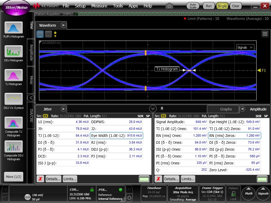

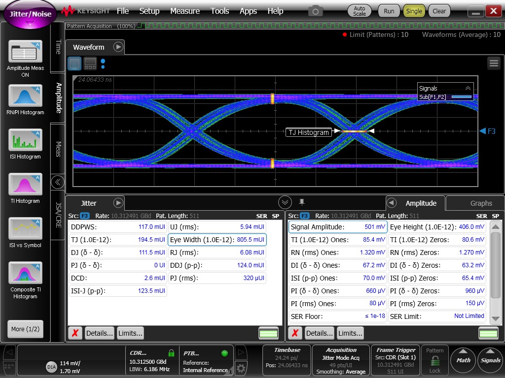

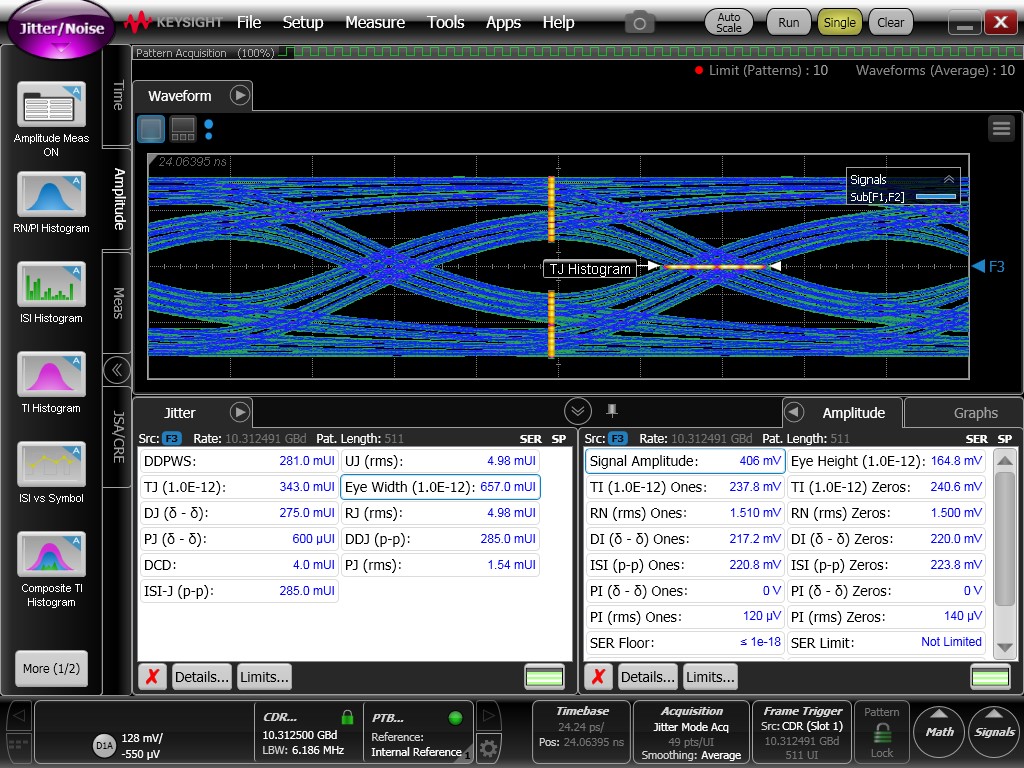

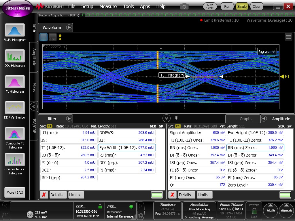

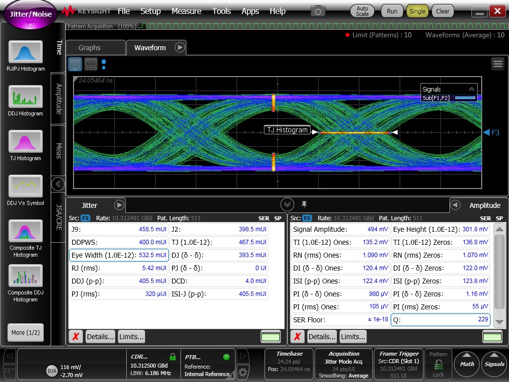

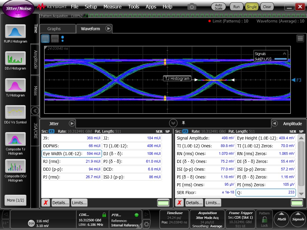

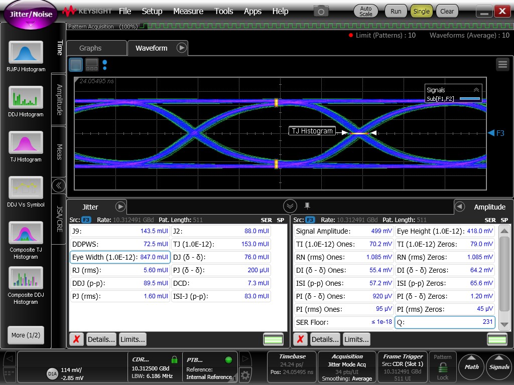

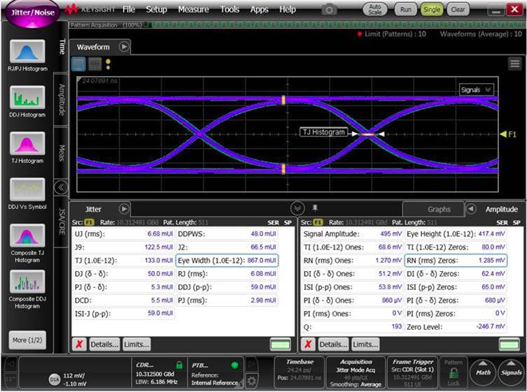

We want to use DS110DF111 as a limiting amplifier in “LIMITING MODULE RECEIVER COMPLIANCE TESTS” in SFF-8431 Section D 1.2 along with Keysight BERT.
For that, Keysight has suggested us to do following:
  1. use the eval board  in SMBus Slave Mode.
  2. set the bit[5] in register 0x09 (to allow the user to override retimed data) and Bits[7:5] in register 0x1E should be 000'b to select raw data.
Can you please confirm if the above configuration will make the eval board to act as the limiting amplifier.
 Because in our tests, even after setting the board as above, the CDR is still ON.
