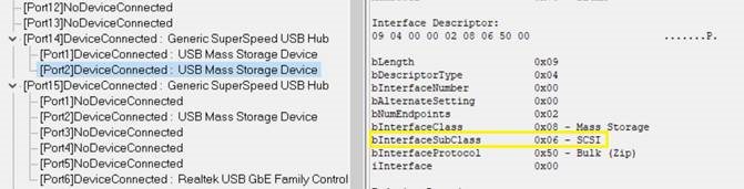

Hi Joe,
Yes, that is correct. ATA Pass-through is via SCSI. As the name indicates it's a way to pass an ATA command directly to the device through the SCSI protocol.
Brian
