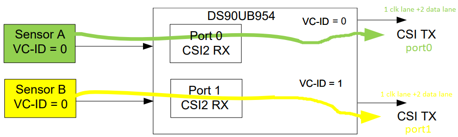

    the datasheet is known to us.
    Can you indicate how do we have to set the register and which register to achieve the following:
    a)
    Sensor A ( VC-ID = 0) remaps to VC-ID =0  ( uses RX0 [pin 41,42])
    Sensor B ( VC-ID = 0) remaps to VC-ID =1  ( uses RX1 [pin 32,33])
    b)
    the image from Sensor A is only present on CSI TX port0 (pin for clk (12,11) pin for data0 (14,13) pin for data1 (16,15))
    the image from Sensor B is only present on CSI TX port1 (pin for clk (19,18) pin for data0 (22,21) pin for data1 (24,23))

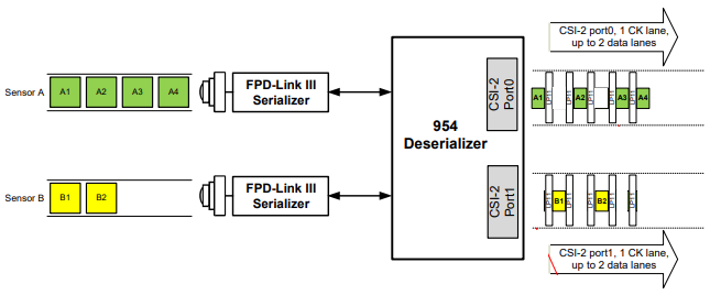

    Here is the picture of what we want to do :

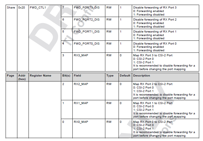

    In the documentation of DS90UB960 the quad de-ser there is register FWD_CTL1(0x20) and the bits [0:3] are mapping the input RX port to CSI-2 port:

  • Hello Bartosz,
    This configuration is not possible using the 954. To achieve this kind of solution you have two options:
    1- Use the replication mode as described in the Datasheet. You will be getting the data of both cameras on both CSI outputs. By using different Virtual Channel IDs, you can separate each camera stream in your Processor.
    2- To use the 960 instead of the 954. The 960 supports natively 4 inputs and 2 outputs. There it is possible to get camera 1 stream into CSI output 1 and camera2 stream into CSI output2.
