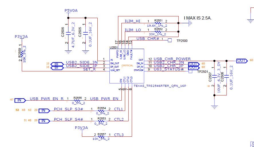

Hi Team,
Could you please help review TPS2546 schematic?

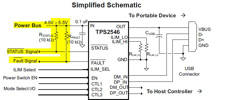

    After looking at your schematic, here are a few considerations that I have.
    1. Make sure that Fault and status are pulled high, preferably to the power bus input voltage
    2. Make sure there are no resistors placed on the D+/D- lines as this can affect the data lines
