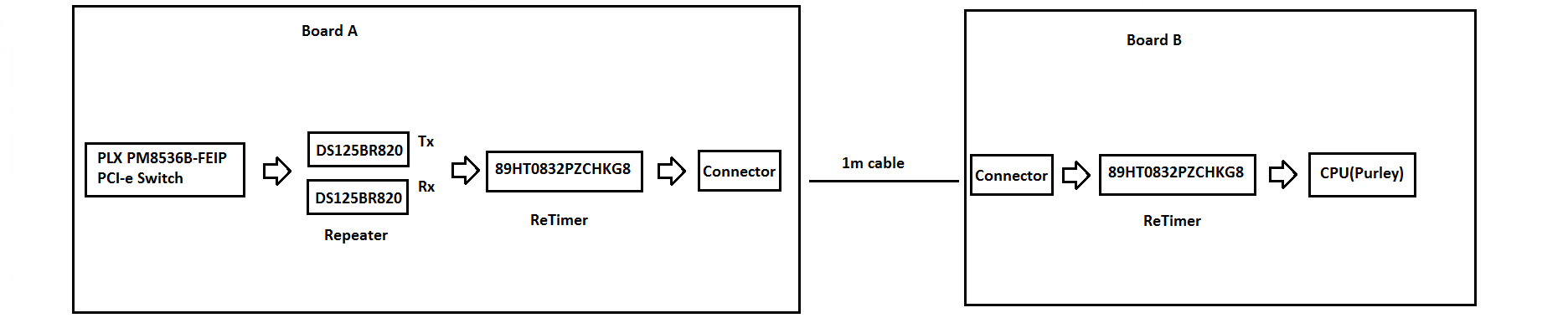

Our customer used as below Block diagram on Product, But have data lost issue.
if we have two board need to transmission on Big PCB size server, than use Repeater & ReTimeris. this okay?
Or Do you have any suggest for Long distance application?
  • Hi Hugo,
    There is nothing wrong with the block diagram in concept.  The DS125BR820 should work well between a PCIe Switch and Retimer.  Can you be more specific about the data loss issue?
    The only issue I can think of with two retimers and the repeater in the link could be receiver detect system timing.  Since the repeaters should always have active PCIe components on both sides you could try to set RXDET pin to the "1" logic level.  That is pull RXDET high to 3.3V if VIN = 3.3V or pull high to VDD if VIN = Float.
    Lee

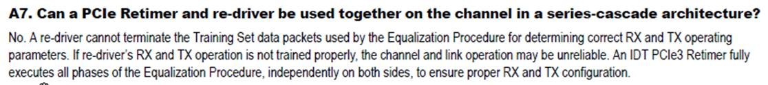

    And below picture is IDT’s document about the retimer and repeater cascade application, FYR.
  • Hi Hugo,
    The DS125BR820 has passed PCI-SIG plugfest testing.  It can re-transmit all of the PCIe Tx presets correctly.  Can you give me additional information about the channel topology and attenuation of the link between the PCIe Switch <-> BR820 <-> Retimer?  It could be the settings which are not optimal for the connected interface.
    Lee
