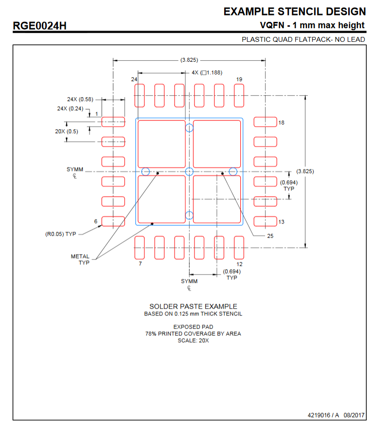

And there are two drawings in the datasheet for the QFN, one has a 2.1mm thermal pad, the other 2.7mm.
I can't make out which is which. I need to ensure the pad on PCB matches the part number.

    So funny story about the ARGER and AMRGER.... They are the same devices but the M version is rotated 90 degrees in the reel.
    Anyways, I had to dig around but I was able to find that both devices have a thermal pad of 2.1
    I 'think' the 2.7 could be a typo though the blue outline suggests it is a recommended stencil.....
    -Bobby

    So just to be sure - if I make my PCB footprint&stencil match the one in the datasheet (with the 2.7mm thermal pad) it will be fine with the 2.1mm pad on the device??
    That seems a little odd to me I have to say.

    I've been digging around on this matter trying to figure out what that page actually is and can't seem to get an answer. I don't think that is the recommended stencil as typically stencils should be smaller for a thermal pad...... (I think there is a stenciling standard which suggests around 80% of the exposed area where as this picture would suggest over 100% which doesn't make sense)
    I believe this to be the stencil:
    What I can tell you is by looking at the older revision (E) that 2.7mm page did not appear until the M version was added in this latest revision (F). The parts are the same so it should not actually change the stencil or pad area at all..... I am thinking this is actually some kind of editorial mistake and those pages you pointed out should not be there.
    -Bobby

    I was finally able to figure out where the 2.7mm thermal pad came from. Looks like our auto qualified TCA9548A-Q1 device got wrongly associated with the catalogue version. We are in the steps to try to unassociate this.
