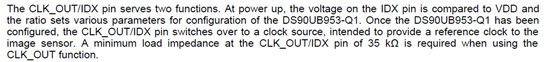

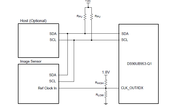

Hi Team,
I would like to know whether the "minimum low impedance is 35KOhm" mentioned in the datasheet below is the Rlow shown below.
Thanks in advance!
Nancy
  • Hi Nancy,
    The datasheet says "minimum load impedance", not "minimum low impedance".
    Load impedance at that node is R(high) in parallel with R(low) since there is a low impedance cap connecting 1.8V to GND. Ref Clk In input impedance is high enough to not matter. The recommended resistors in Table 8 meet this requirement.
