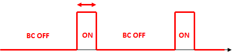

In order to improve the receiver eye integrity, my customer tries to implement the sequence which turn-on and off the backchannel communication with 0x02[2].
i.e. the back channel is enabled only when it's required.
Would you please let me know the minimum duration which requires for UB913A and UB914A to communicate and configure correctly?
Again, no guarantee required...

Not sure why they would want to switch on and off unless they are multiplexing two cameras or inputs.
This is not a validated use case so we wouldn't have timing info to provide. By the way, the register should be 0x01[2] for BC enable/disable.

  • Hello Ken,
    The forward channel will still function normally when the back channel on the 914A is disable.
    If customer does not need communication over the back channel, there should be no problem to turn it off.
    As Pal mentioned, ideally the customer would fix their design. It would be prudent to wait a minimum of 100ms after enabling the back channel before attempting any I2C communication from the deserializer to the serializer. As disabling back channel is non-standard use case it is recommended customer to perform validation at the system level.
