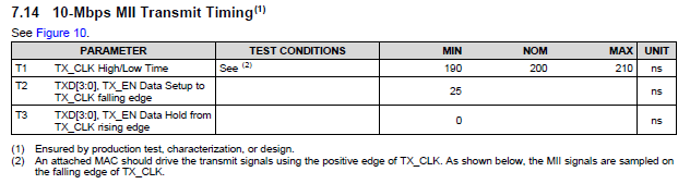

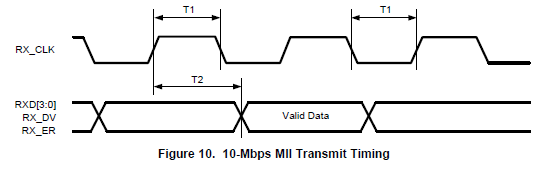

My customer has a question about DP83867IR/CR.
[Q]
There is an error about 10-Mbps MII Transmit Timing Diagram in the D/S Figure 10.
Is my understanding correct ?
<SNLS484E>
I think this is not correct as Transmit Timing.
* T1 is correct.
* T2 is not correct.
*T3 is not described.

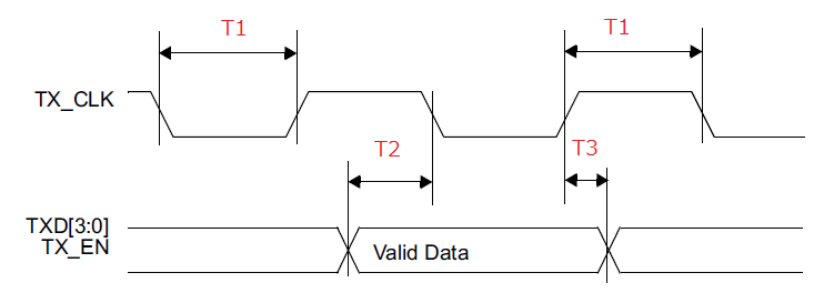

<My understanding>
I brought the following timing chart from DP83849I D/S.
