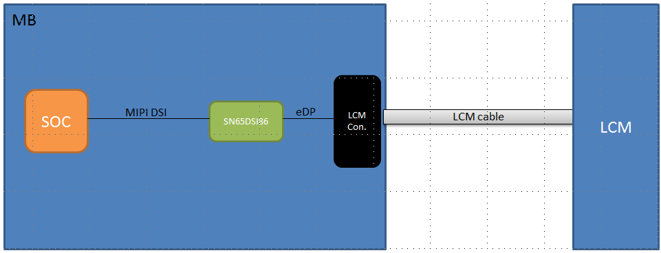

Dear
SOC vendor recommend MIPI DSI routing impedance 85 + - 15 ohm,
SN65DSI86 recommend MIPI DSI/eDP routing impedance 100 + - 15 ohm
Which solution is TI suggestion?
Option 1. MIPI DSI 90 + - 10 ohm, eDP 90 + - 10ohm, LCM cable 90 + - 10ohm
Option 2. MIPI DSI 85 + - 10 ohm, eDP 100 + - 10ohm, LCM cable 100 + - 10ohm
p.s. + - 10 ohm is PCB manufacturing variants
BR
Ethan
