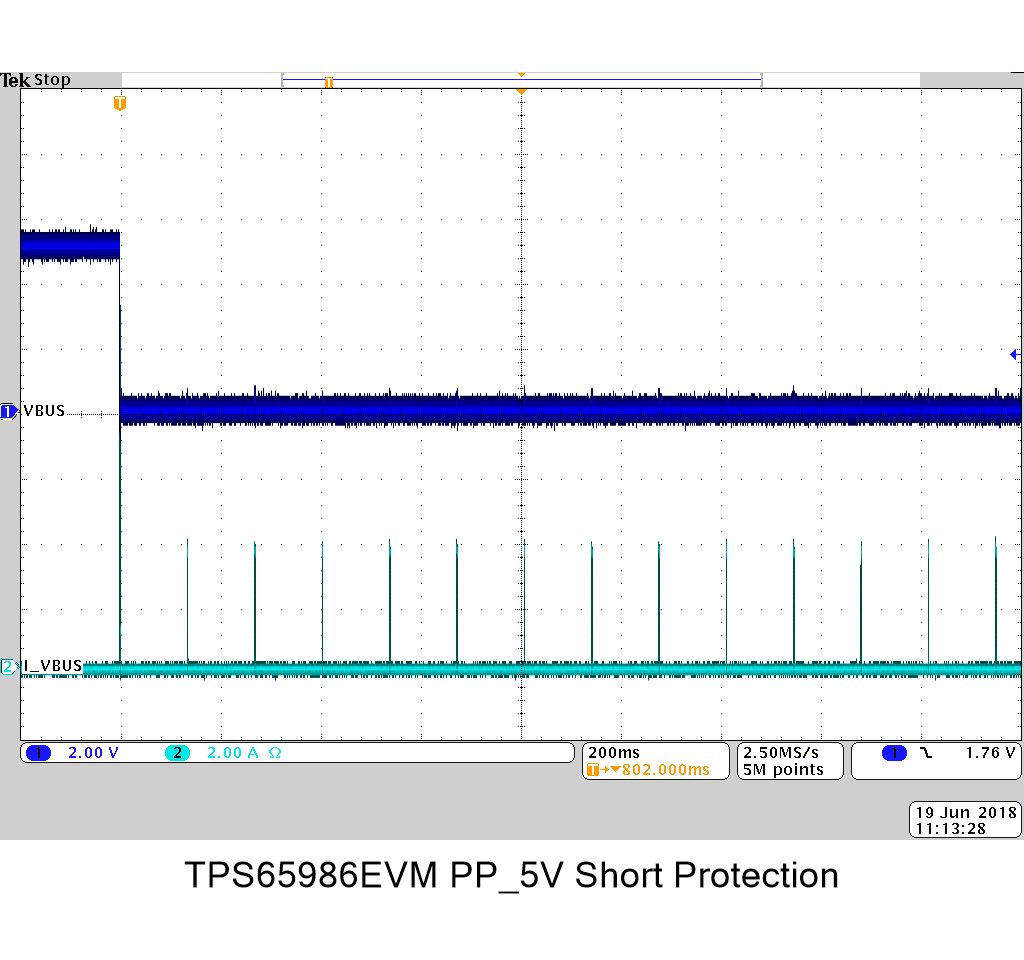

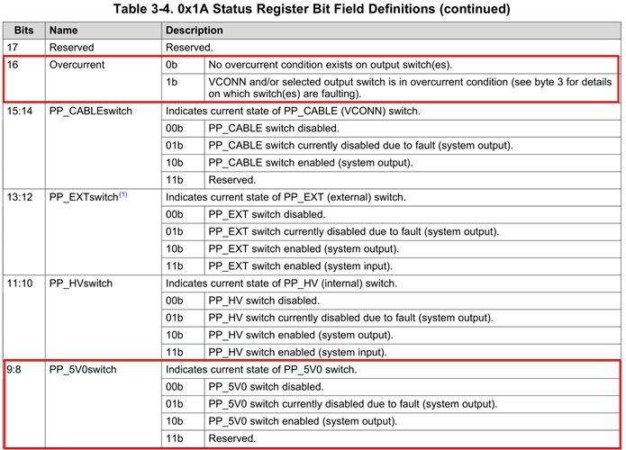

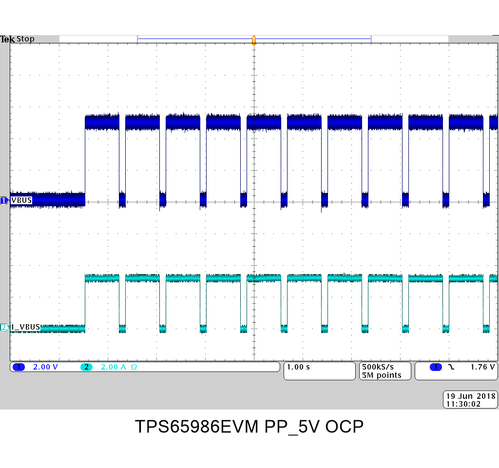

I would like to know about over-current protection operation.
Will it return to normal operation automatically when it is no longer over-current?
Or will you keep maintaining over-current limit state unless resetting etc is done?
