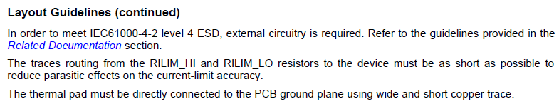

My customer wants to know the trace length limitation in TPS2546 for USB2.0 signal. They saw a limitation on Intel Coffee lake platform PDG shown below. Total Motherboard Trace Length maximum is 6000mils. Do we have limitation on trace length for TPS2546? Thanks!

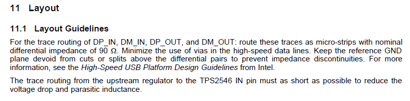

    I do not know of any trace limitations for the TPS2546, but keeping the D+/D- lines as short as possible is a  good practice. Having it be below 6000 mils is a good number to aim for. The only layout guidelines that are mentioned in the TPS2546 datasheet is shown below.
    Let me know if this answers your question or not! If so, please click This resolved my issue
