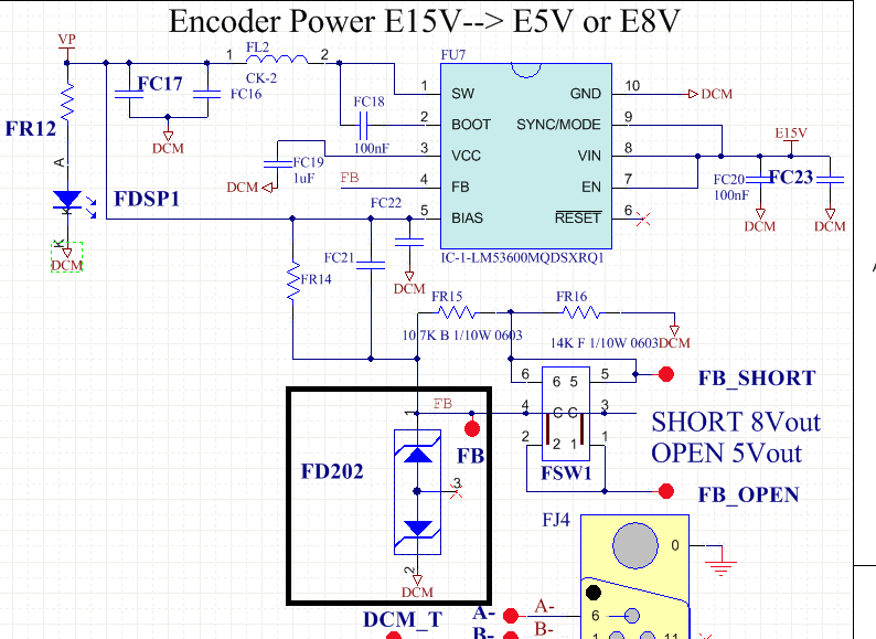

My customer is using LM53600 as buck converter on motor encoder circuit design. They would like to protect FB pin of the LM53600 buck converter from ESD strike with up to +/-9KV air. is there any passive component suggestion to protect FB pin from ESD strike?
