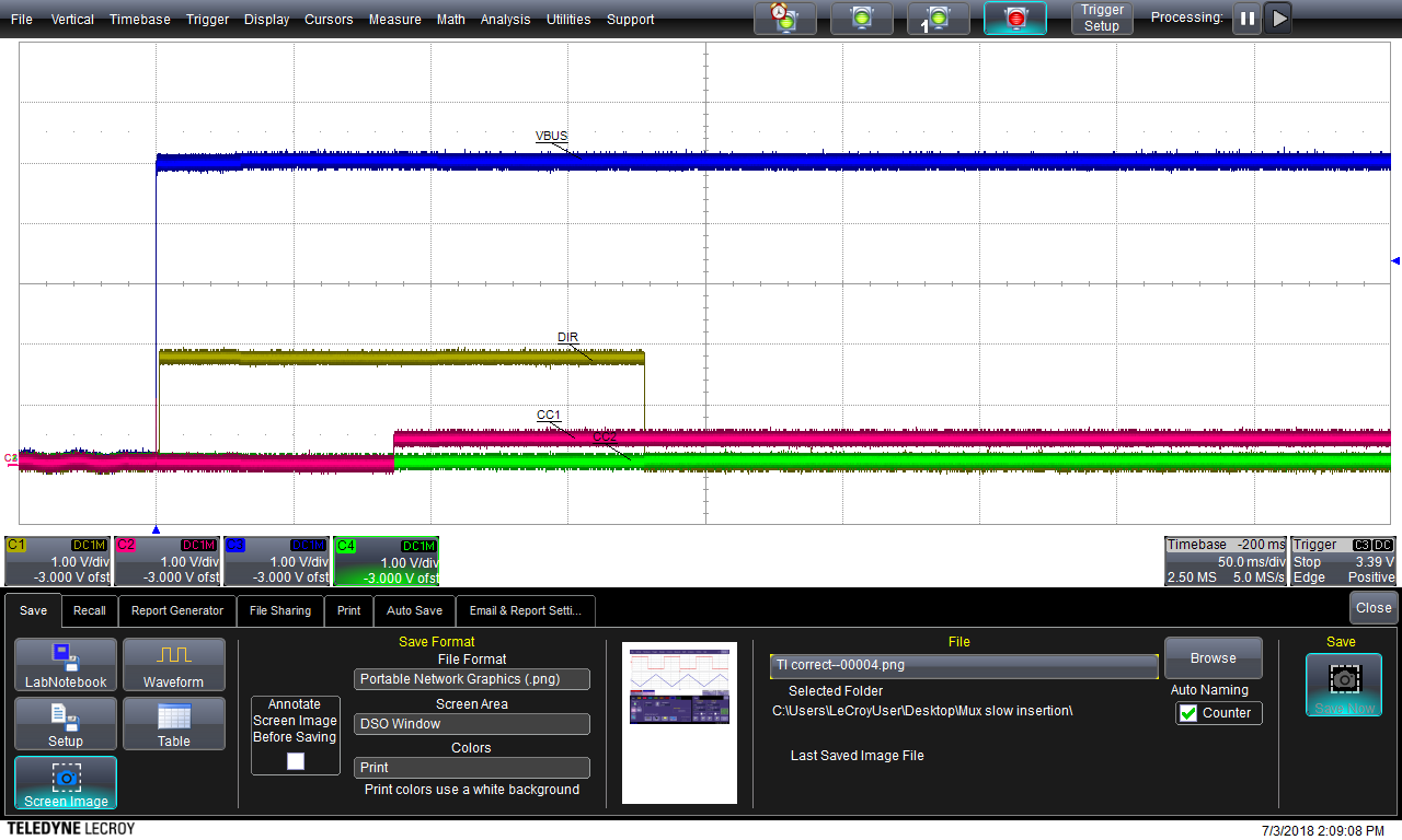

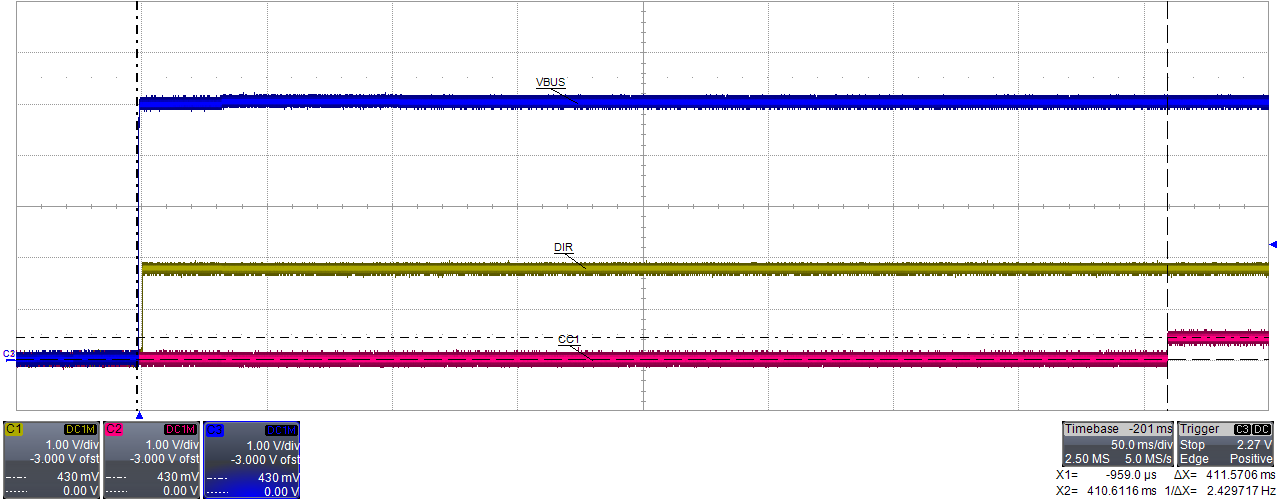

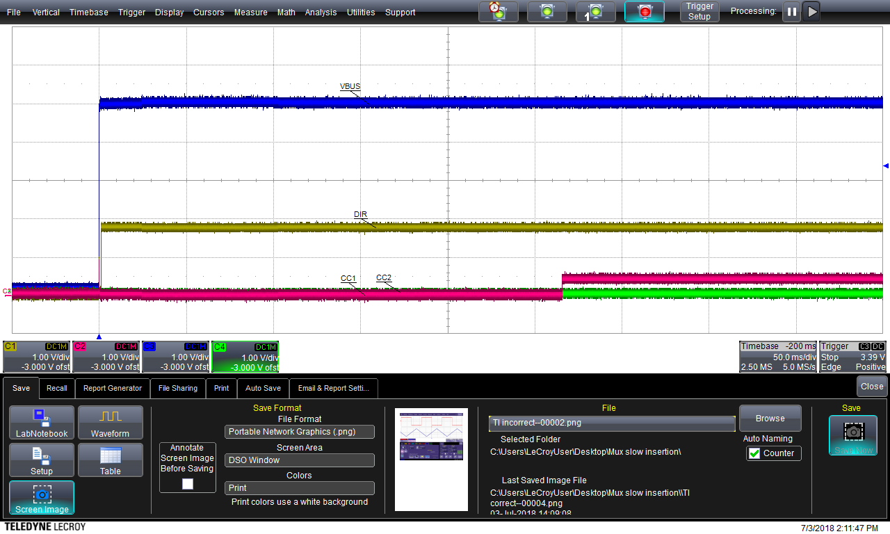

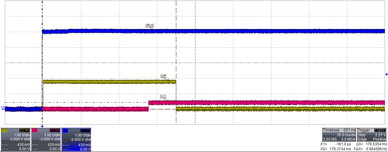

Hi.
I have exactly the same issue that was discussed in "TUSB321 not detecting cable inversion" thread, i.e.:

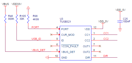

I'm using the TUSB321 as UFP configured according the spec.
I'm using Type-A to Type-C certified USB3.0 cable.
Once the Type-C plug is connected a little bit slowly the TUSB321 fails to detect cable inversion.
Currently the "TUSB321 not detecting cable inversion" thread is locked, so I'll be more than happy to know if there is a solution for this issue?
Thanks.
Alexander.
