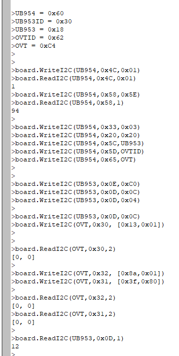

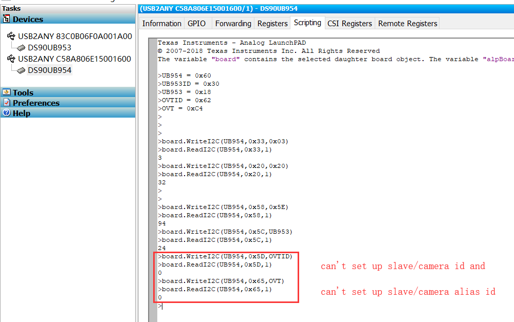

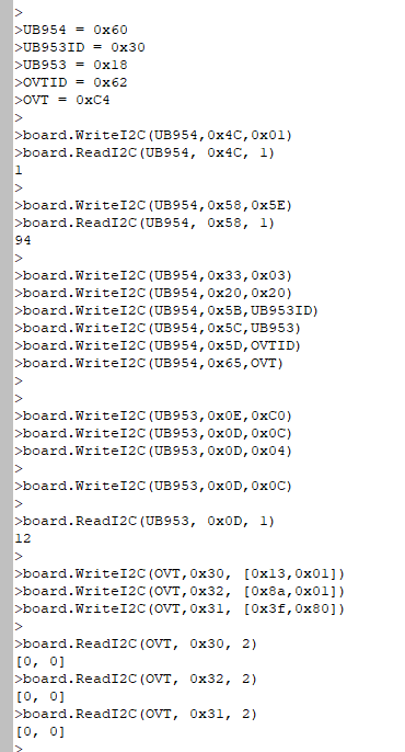

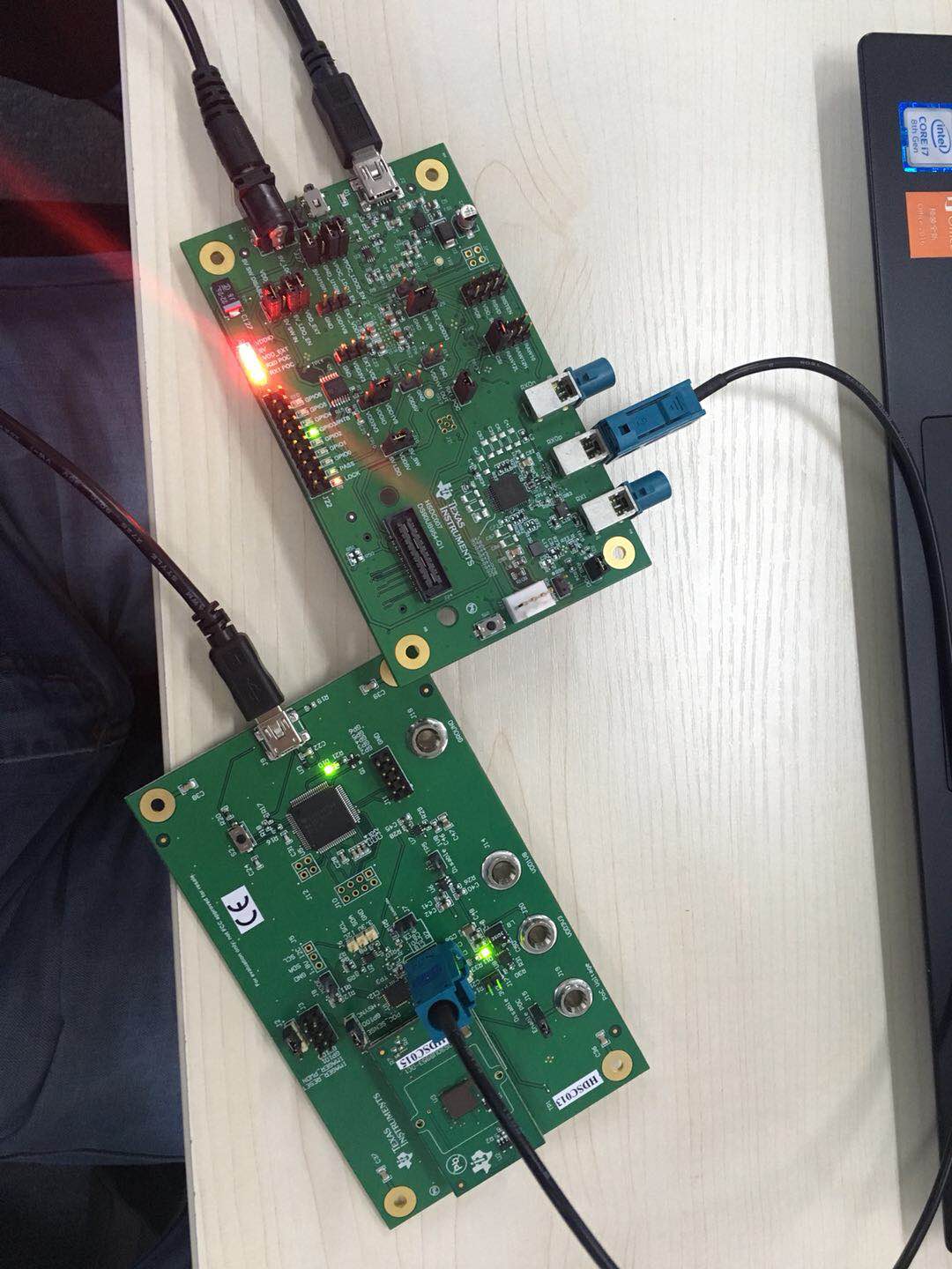

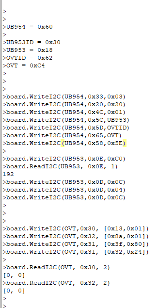

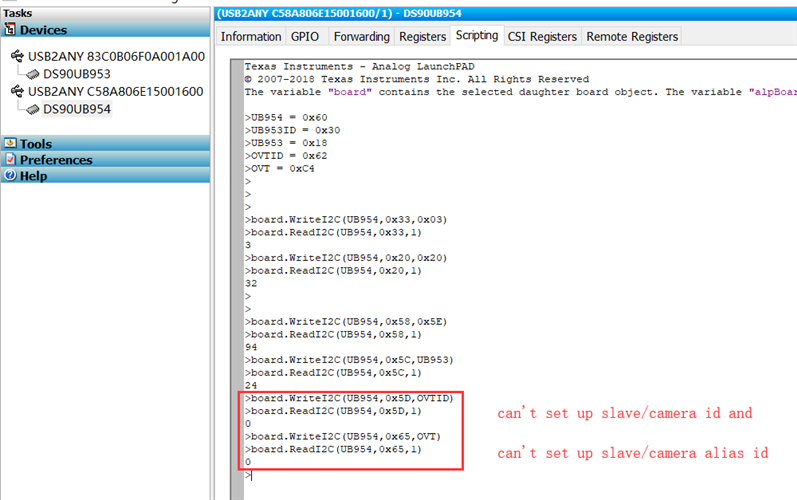

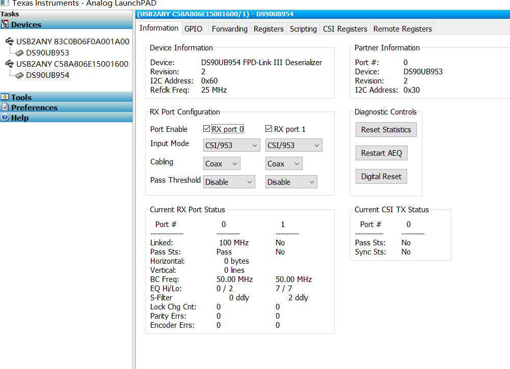

I am using the DS90UB953-Q1EVM and DS90UB954-Q1EVM . And i run the P954_A0_RX0_CSI_Enable.py script  and  the ovt_1920_1080_REMOTE.py script to initialize
eht EVMs and camera.but i failed. i found slave/camera ID and alias ID are unable to write . Can you help me ?
