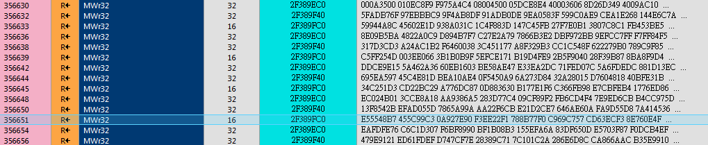

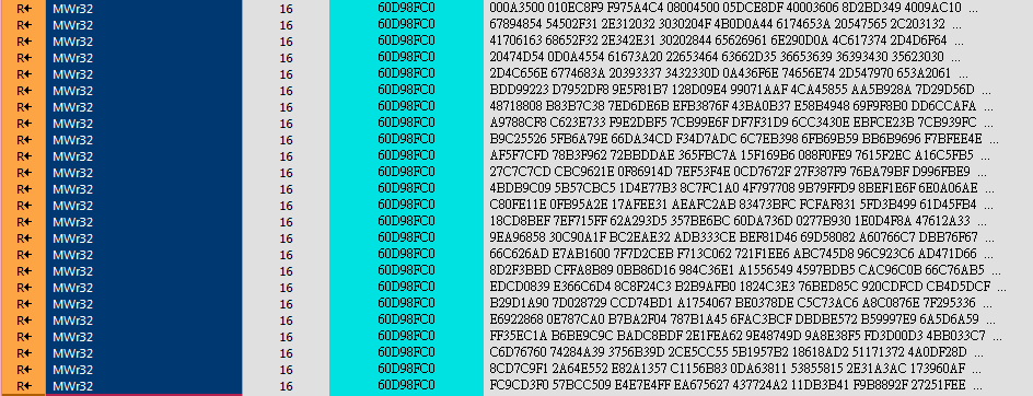

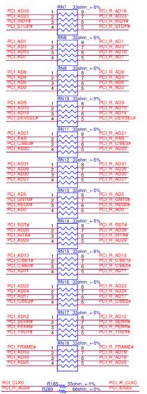

We are using TI XIO2001 and we found something strange in DMA.
1. When PCI transmit a long single upstream DMA, the transaction could be divided to several PCIe packet with smaller frame size. The address decoded by XIO2001 could be in correct. It’s should be increases instead of below picture :
2. It’s could be no address change when the start address is 32’hxxxx8fc0 with 16Dword size.
The address is allocated by OS and the divided size is decided by XIO2001. It’s seems an address counter overflow phenomenon. How should we do for this issue?

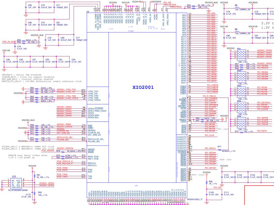

Here’s the schematic for XIO2001

    It’s not an Rx overflow. It’s address counter of XIO2001. Or we should said : memory boundary. For example,
    Case1 :
    if you get a destination address 0x2F389000 with size 128 double words. It will work fine :
    PCIe Wr : 0x2F389000 : 32dword : data sec1
    PCIe Wr : 0x2F389080 : 32dword : data sec2
    PCIe Wr : 0x2F389100 : 32dword : data sec3
    PCIe Wr : 0x2F389180 : 32dword : data sec4
    Case2 :
    if you get a destination address 0x2F389EC0 with size 128 double words. The address will be incorrect after counter reach 0x2F389FFF :
    PCIe Wr : 0x2F389EC0 : 32dword : data sec1
    PCIe Wr : 0x2F389F40 : 32dword : data sec2
    PCIe Wr : 0x2F389FC0 : 16dword : data sec3
    PCIe Wr : 0x2F389EC0 : 32dword : data sec4 – why it’s not 0x2F38A000 (0x2F389FC0 + 16dword)
    There should be some setting for adjusting this kind of counter boundary.
    PS : The destination address should be allocated by OS, we can’t change it in easy way.

    Do they see this issue with both a 33MHz and 66MHz clock? Also, have they made sure to implement everything in the errata? www.ti.com/.../scpz008b.pdf
    I.K.
  • Hi Sirs,
    Thanks for your reply.
    Our update as below
    I think this document descripted 5 discovered issue for XIO2001…
    Should I implement those work around even we don’t have the issue listed in the descript?
    For issue 1 and 2
    We are not using Serial Interrupts, Legacy INIT_A instead.
    For issue 3
    We didn’t find issue related to power and CLK_REQ# yet
    For issue 4.
    We don’t have TLP transfer halt issue?
    For issue 5.
    The issue occurred with floating EXT_ARB_EN and CLKRUN_EN unconnected. We are pulling down with 10k currently.
    If those issue impact the address calculating during DMA section?

    I have consulted with a designer and it appears that the customer is bumping into a 4k boundary that the PCI spec prohibits crossing. The software they have has to be aware of the boundary and handle it accordingly.
    I.K.
  • Hi Sirs,
    Thanks for the answer, I think it’s a confirmed about this is a memory boundary limitation. Could you please tell me which solution is the most common solution?
    1. System provided a space(or a destination space) which will not have boundary crossing possibility
    2. PCI card separated the transmit request by themselves
  • Hi Shu-Cheng,
    I would assume that number 1 is the most common solution.
    I.K.
