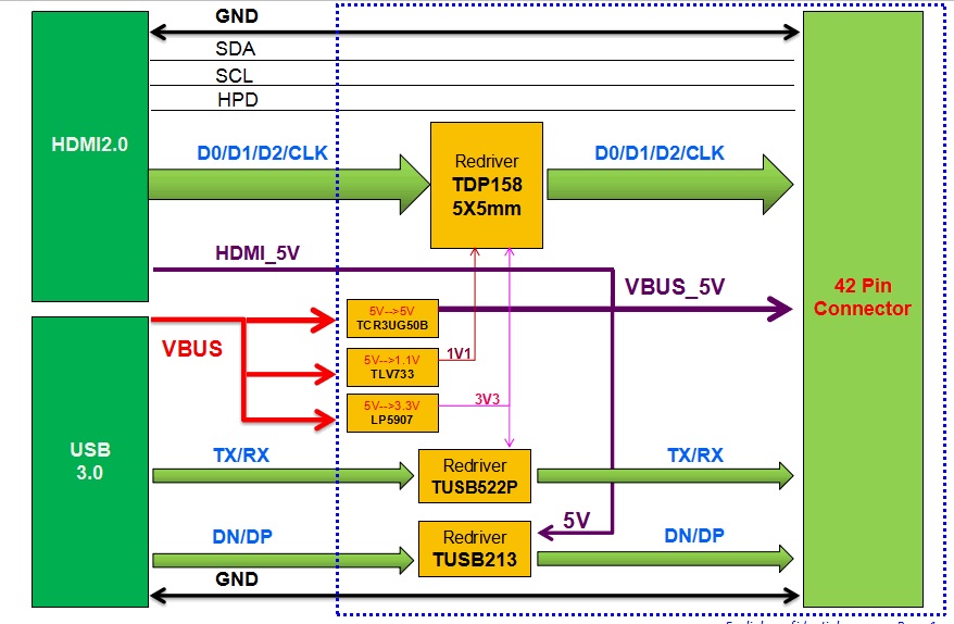

Hi Sir,
I'm estimate HDMI2.0+USB3.0 to 42 Pin connector Cable solution, the length is around 5~10m and need redriver.
could you help check below function block, if don't has any issue, will start to implement .
thanks~
Driscoll
