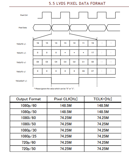

In an effort to reduce the number of lines coming from the camera we are using, I'm attempting to convert the LVDS coming out of the camera to FPD-Link III (or any low-conductor output) using the DS90UB947-Q1. We will be streaming at 720p/60 or 1080p/30. Attached is a non-detailed timing diagram of what is happening at the output of the camera. I've also attached a diagram of the interface.  This is new territory for us, so any information would be helpful.
