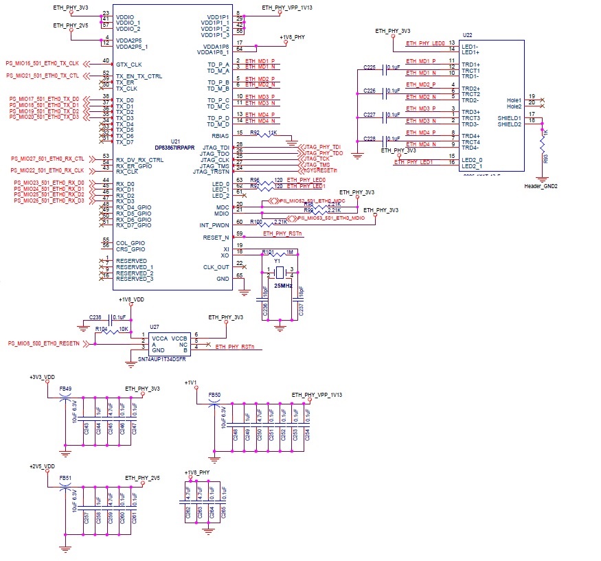

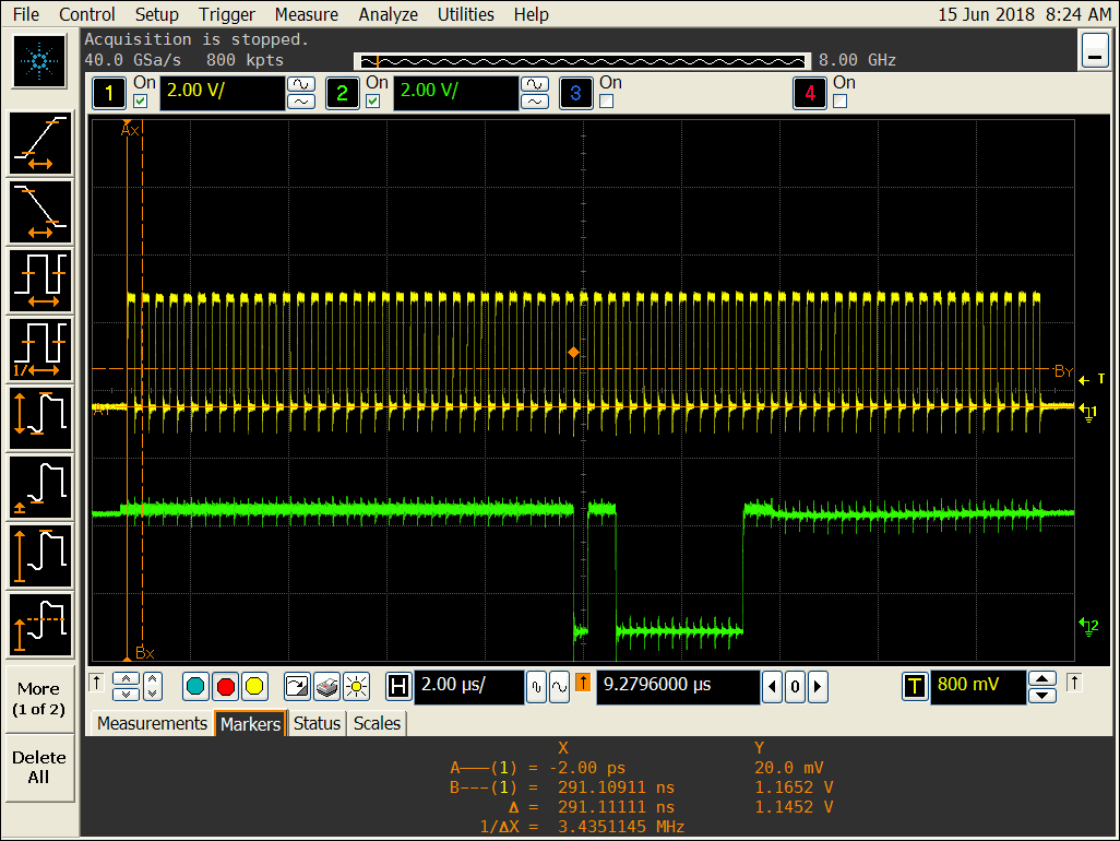

We used zynq platform and DP83867IRPAPR for Etherent function. I used u-boot mdio command to debug, but the device no any reply. I double confirm the scope. Could you help me to find the issue?
I have checked the as below item.
1. power supply ==> correct
2.CLK_OUT => 25MHz  correct
3. Reset_n ==> keep on high
I check schematic PHY address, should be 0x00.
Board: Xilinx Zynq
