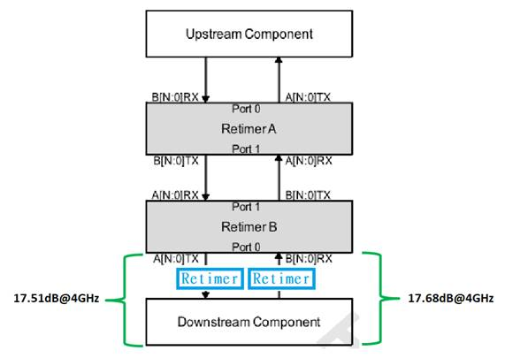

Hi Sir,
Please refer to picture below.
  • Hi Sir,
    I just update detail signal loss information(all value@4GHz) and diagram as below.
    Attached file is our current EEPROM setting of repeater.
    So far, we guess the repeater driving strength is too strong on the TX side that goes to retimer(mark in red circle).
    We are trying to lower it.
    If you have other suggestion, let me know.
  • Hi Hugo,
    I did not see the EEPROM configuration file attachment.
    Based on the diagram here are the settings I would suggest.
    Upstream: (towards CPU)
    Function       Register value
    EQ                02'h  (Datasheet - Level 3)
    VOD             100'b  (Datasheet - Level 4)
    VOD_DB      000'b
    Downstream: (towards PEX)
    EQ                01'h  (Datasheet - Level 2)
    VOD_DB      000'b
    Lee
  • Hi Sir,
    Add the EEPROM configuration file
    JBOF_20171225(VOD_DB_000_Max_VOD_010_0.71).zip
  • Hi Hugo,
    I adjusted the file to decrease the equalization gain.

    Lee
  • Hi Sir,
    Thank you very much,
    We will pass to customer try it.
    Hugo
  • Hi Sir,
    This issue improve.
    our Customer have other question,
    If the trace is too Long over one DS125BR820 capability,
    Do you have any suggest for this application?
    Hugo
  • Hi Hugo,
    We like to avoid using multiple redrivers whenever possible.  Without direct knowlege of vendor link training algorithms there is more risk to the link adapting to a non-optimal configuration.  Typically in PCIe applications at Gen3 we can utilize a single redriver for links up to ~30dB.  The actual maximum loss is highly dependent on the layout and system components.
    Lee
