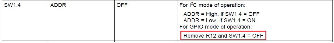

Regards to TUSB320LA-EVM, I have below problems need your help to clarify. Thanks!

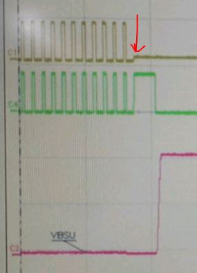

- As TUSB320 datasheet mentioned below, UFP mode can support Accessory mode with UFP only configuration. But, when we insert the type-C headset to TUSB320EVM, there is no any response. We provide 5V to TUSB320 and configure it as GPIO mode. The D3/D4 LED doesn’t illuminate. After checking type-C spec, I think it’s not possible to detect a passive accessory mode under pure UFP mode. Because the CC1/2 are both Rd and there is also no VBUS come from external type-C headset. Only if the type-C headset can provide VBUS power right?
- When we configure TUSB320 as DRP mode and GPIO output mode, it can detect the type-C headset (D3 LED lights up). But the problem is when I remove the headset. The D3 LED would stay lights up(D4 LED turn off). Until I recycle VDD power or the /EN pin, the D3 LED would turn off.
- When TUSB320 is configured as DRP mode and GPIO output mode, the LED D1/D2 doesn’t light up when a type-C adapter inserted and charging the phone hooked at micro-USB port(the phone is under charging normally). Per check the datasheet, it doesn’t describe whether the OUT1/OUT2 can indicate the type-C charging current under DRP mode. The strange thing is that D3 LED would illuminate while the type-C adapter inserted, why?
TUSB320LA EVM under testing:
