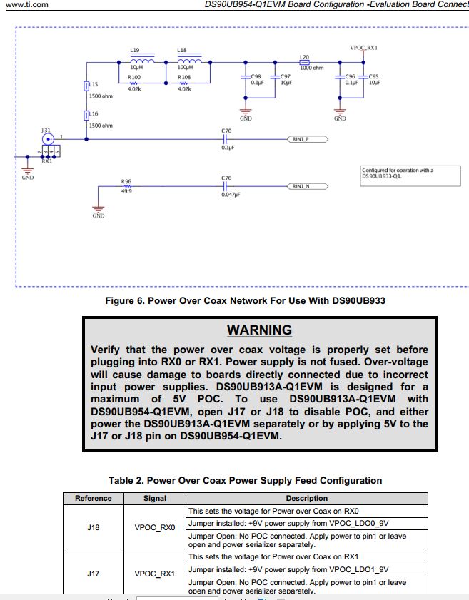

I am using DS90UB954-Q1. I have connected an FPD III coaxial camera to the RX1 PORT
I am applying 12 V DC to  J1
I want to vary the voltage from 0 to 16V   that can change the voltage to the camera connected at RX1 PINS.
Is there any way we can change the jumper setting the variable voltage can be provided without any damage to the board.
