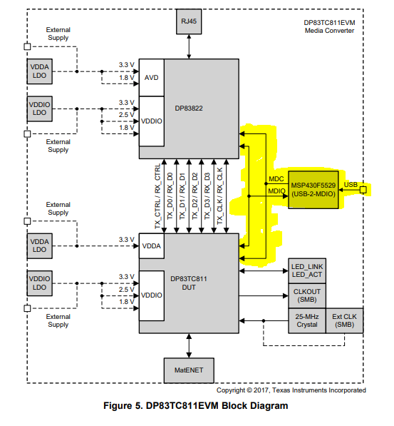

Does this board uses a micro to configure the phys or the back to back connection works right away? Will there be a need for a software?
  • Hi klajdi,
    The back to back connection works right away based on strapping of the 811 and the 822.
    There is a controller on board that allows configuration to be applied to the 811 or 822 depending on the testing needed.
    What are you planning to do with the EVM, and perhaps I can help you further with what you will need to do.
  • I was planning to layout a board that contains the 2 phys, just to use them as a converter but I am not sure if the 2 phys alone are going to work without MCD and MDIO lines connected to them. Will the following configuration work (without the highlighted components) without needing any firmware ore configuration?
  • Hi Klajdi,
    Yes, the converter will have the data path working without the controller present.
    If you plan to do any advanced testing with the converter, like OA compliance, then access to the MDIO to do register configurations will be required. For further information I would have to connect you to a TI FAE.
    Please let me know if you need more help and I will try to get an FAE in contact with you.

  • Hi Manfred,
    If you are interested in using the datapath only, to do TX to T1 conversion, then the media converter does not require software.
