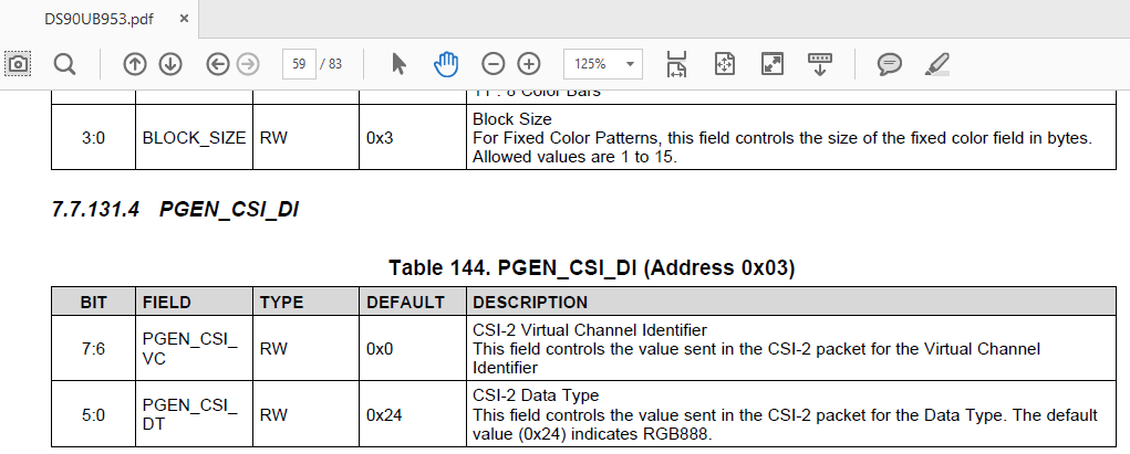

Hi TI Experts,
We have a customer using DS90UB953+954 in their design.
Now they would like to use the color bar pattern generation.
We can find the default CSI-2 Data type is RGB888, How could we set this register to make it send RAW10 type of CSI-2 packet?
Is there an register reference manual?
