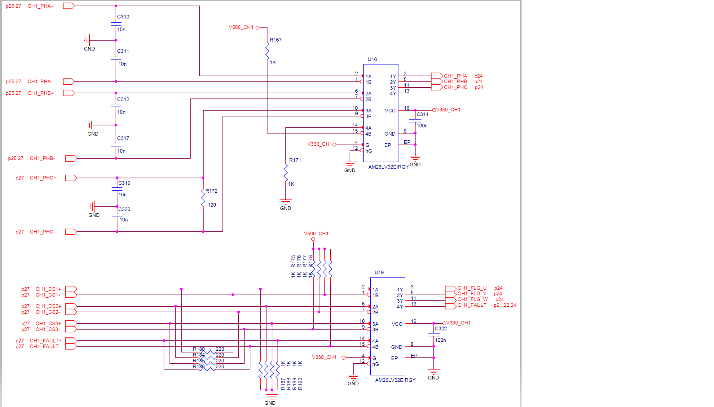

Hello Support Forum,
Based on attached schematics, please review attached implementations.
Tried to follow the reference schematics as much as possible.
Thank you & regards,
-albin
  • Hi Albin,
    4A (pin 14) and 4B (pin 15) can disconnected and left open. The device will drive the output (4Y in this case) to a default high state which can be left disconnected.
    If this is the last receiver on this bus, I would recommend including termination resistors on CH1_PHA and CH1_PHB as well to help improve signal integrity for longer cables or high data rates.
    The termination resistance of 220-Ohm on the U19 device is a bit higher than usual. This value normally ranges from 80-Ohm to 120-Ohm depending on the cable. Is this value based off of the cable impedance?
    This device also has internal fail-safe biasing so the external biasing on the second device is providing a larger margin when the bus is idle. Is this providing biasing for other nodes on the same bus?

    Re: "4A (pin 14) and 4B (pin 15) can disconnected and left open. The device will drive the output (4Y in this case) to a default high state which can be left disconnected."
    Would above have to do with internal fail-safe biasing? Kind of unsure if it can safely be disconnected and left open. Please confirm.
    Re: "The termination resistance of 220-Ohm on the U19 device is a bit higher than usual. This value normally ranges from 80-Ohm to 120-Ohm depending on the cable. Is this value based off of the cable impedance?"
    Compared to your suggestion, how would performance and noise immunity be affected if I have 220-Ohm termination resistors on both the transmitter and receiver side based on a standard 4m cable with typical impedance?
    Re: "This device also has internal fail-safe biasing so the external biasing on the second device is providing a larger margin when the bus is idle. Is this providing biasing for other nodes on the same bus?"
    I don’t see these internal fail-safe biasing parts (diagrams in section 8.2?) in datasheet. Please confirm.
    -albin

    Re: "Would above have to do with internal fail-safe biasing? Kind of unsure if it can safely be disconnected and left open. Please confirm."
    The internal fail-safe bias ensures that if the input to the device is left open, disconnected, or shorted, the receiver output stays in a known state. It is recommended that unused inputs are left open. Externally biasing the input will cause the system draw more current.
    Re: "Compared to your suggestion, how would performance and noise immunity be affected if I have 220-Ohm termination resistors on both the transmitter and receiver side based on a standard 4m cable with typical impedance?"
    Termination resistance is based off the characteristic impedance of the cable being used. This resistor value should be within 20% of this value which ranges between 80-Ohm and 120-Ohm. Most twisted pair cables have a characteristic impedance of 120-Ohm.
    You should only use a termination resistor at the last receiver on the bus. No termination is needed at the driver for RS-422 devices.
    Re: "I don’t see these internal fail-safe biasing parts (diagrams in section 8.2?) in datasheet. Please confirm."
    This diagram only depicts the basic functionality of the receiver. Description of the fail-safe conditions can be found in section 8.4 of the datasheet.
    Let me know if you have any other questions.
